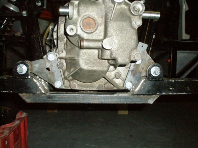

Just installing my engine/box into my GTD/southern GT adapted chassis. I'm going to need to make up some gearbox mounts. I'm presuming the centre (split) line of the gearbox is actually central and should be on the exact centre line of the car?

you're correct in your assumption, but don't forget that the rear cover is not symetrical about the centre-line. You will may need different mounts either side. Attached photo are my rear mounts after the the engine and transmission.
