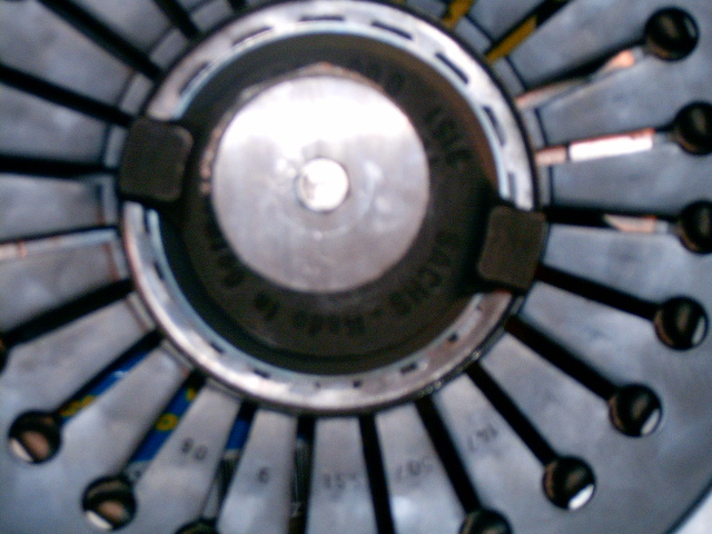

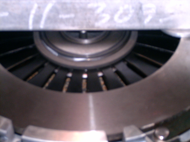

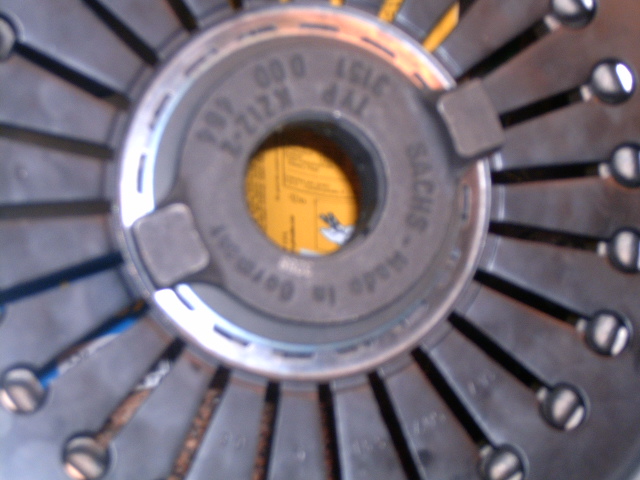

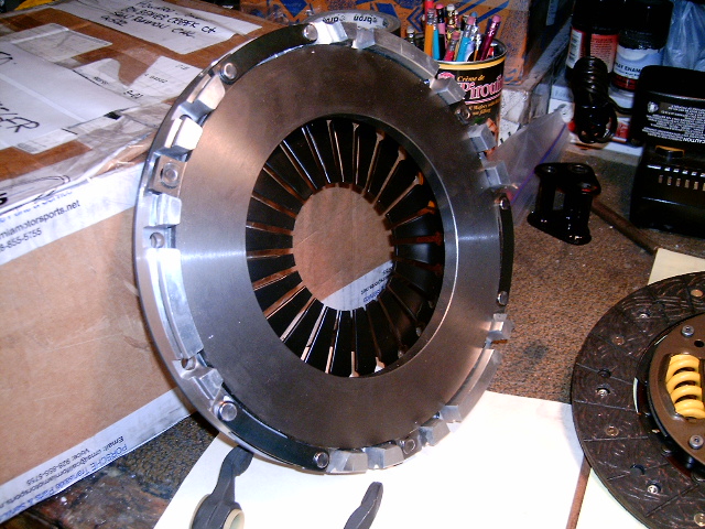

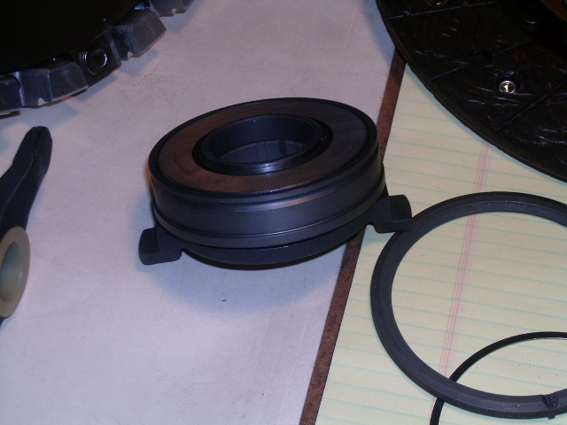

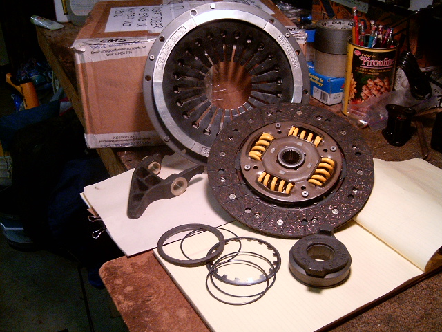

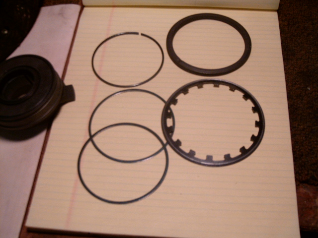

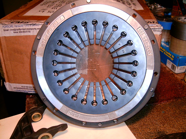

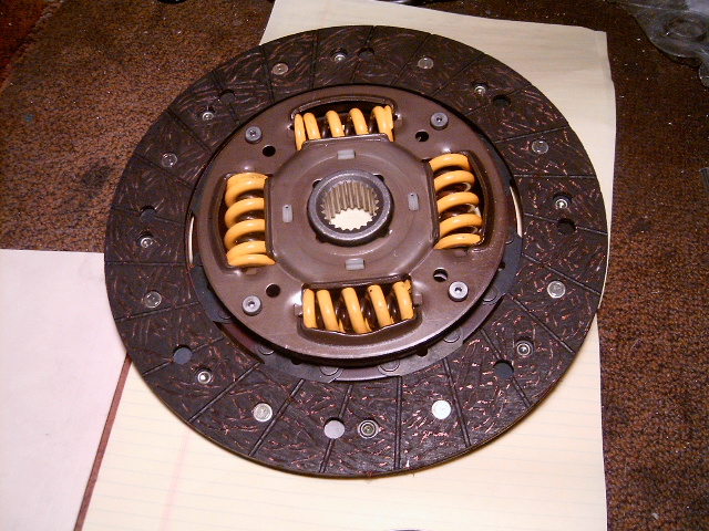

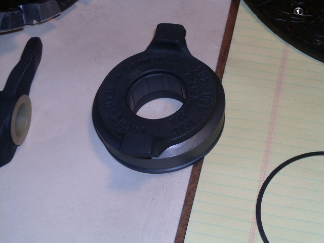

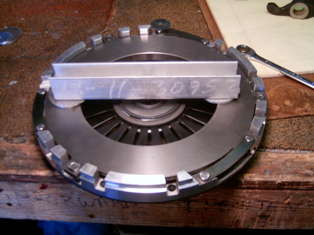

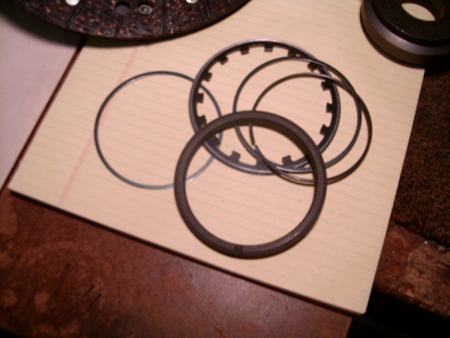

I am looking at my brand new Sachs clutch and I haven't a clue where to start. I believe it is a turbo type and it a hydraulic drawn release type. The release bearing is in several parts and I can't even get that together. I have a feeling that the T.O. bearing goes between the flywheel and the pressure plate. I have never worked on a Porsche and I've never even seen one together before, so I need some help getting started. Pictures would be helpful.
Pictures of what I have attached, thanks.
Oh I forgot. Once you have the lock tab removed from the T.O. bearing fork shaft how do you get it out so that the fork can be installed. I didn't want to start pounding on things so I though I should ask first.

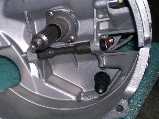

Heres a clue :-
The fork shaft -- take out the retaining bolt and pull the shaft out --should slide out freely

Howard, I can't help with the guts of the clutch itself, but I have had more experience than I wanted with the release fork & g/box r&r !
As Chris says, once the locking tab has been removed, the fork shaft "should" just slide out - mine didn't. I ended up cutting a couple of short lengths of steel tube with an ID just larger that the shaft dia. Place the tube over the outside end of the shaft & use a large dia washer to cover the end of the tube. Then run a suitable bolt thru the washer & into the threaded hole in the shaft (5mm, I think). Tighten up the bolt & it pulls the shaft out. Mine was very tight & I had to use a second, longer tube to get it all out (travel is limited by the depth of the threaded hole in the shaft).
The re-installation of the fork & shaft as you are installing the g/box can be a nightmare, BUT, can be made a whole lot easier by :
a) grinding a 2mm chamfer around the blind end of the shaft - this makes it so much easier to get it thru the fork bearings & into the far-end bell-housing bearing. (Remember, you are doing this with the g/box closed up to the adaptor plate, so access is only via the small openings in the bell-housing).
b) when you slide the g/box into place, you need to suspend the release fork so that the fork lugs are in front of the release bearing lugs & all is centralized. Bill Bayard gave me the clues on this one - suspend the fork by running a number of elastic bands under the fork lever & up to the ring-gear teeth. You can centralize the fork my moving the elastic bands over the teeth of the ring-gear as required.
c) Once the g/box is mated up, you can twiddle the lower end of the fork to get the shaft to go through the fork bearings, then into the RHS bell-housing bearing hole (hugely easier if you have the chamfer on the shaft as per (a) above).
After this, I usually (how depressing to have to use that word !) pull as much of the elastic bands out as I can with a hook on a coat-hanger, then let the starter motor grind up the rest.
I hope that this helps a bit.

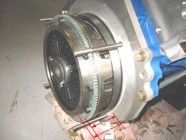

may be this pics help too ( i think they are from Ron)
I think this shows how to fix it for the installation

Thanks for the last pic Tom. I've been looking for that one too.

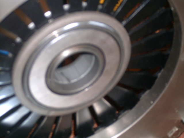

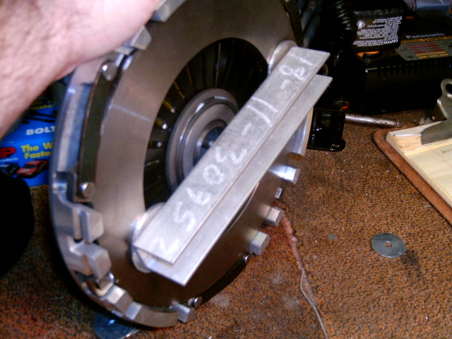

Went out in the garage and in 15 min had it together. The pivot shaft came right out aftr I pulled off the plastic plug and the T.O. bearing went right together. I made up a press from some leftovers and..........WALA done.
