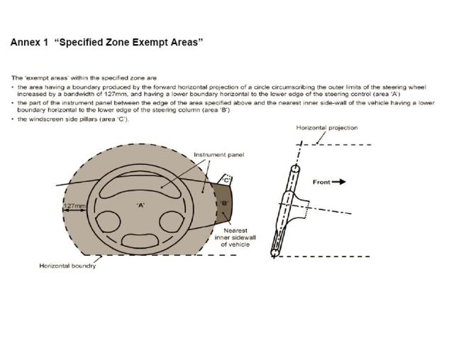

Paul, See attached for exempt area, Section 12 doesn't seem to specify the need for a windscreen. BTW the projection is 3.2mm for normal fittings. The switch statement is below, I would go the loop route for the test like a Mini:
<TABLE dir=ltr borderColor=#000000 cellSpacing=2 cellPadding=7 width=539 border=1><TBODY><TR><TD vAlign=top height=0>
All switches, control knobs etc which are mounted on the instrument panel which are within the "specified zone", contactable by a 165mm diameter. Sphere and protrude from the instrument panel by more than 9.5mm must be likely to retract or detach with no sharp edges when subject to an impact of 40kgf (see Note 5)
</TD></TR></TBODY></TABLE>
On the immobiliser, I hear the cut off switch with removable key is sufficient. If you had a MSD control, they also have a function that you can kill the spark, just use a key switch instead of a toggle.
Brett

Originally Posted by paulmartinjones View Post
I’ll use the loops mentioned above to protect them. But, surely they will protrude more than 9.5mm and therefore need to be able to be broken off without leaving sharp edges (if not in the exempt zone….) which they won’t???
Some days I thank Ford for training me up as an auditor in the days gone
Paul the key piece is to read the text very carefully. I know its easy to scan read and misinterpret things. The passage in question states:
The key piece here to focus on is phrase contactable by a 165mm diameter sphere AND protrude blah blah
Therefore if you make your loops so that the sphere can not contact them then you won't have to get them to do the impact test.
On the windscreen. Best thing to do is to write to VOSA, get the response and file it for your safe keeping and then ensure you have it with you at the test. That way you will be able to plan your cabin effectively and have the necessary back-up if/when challenged.
