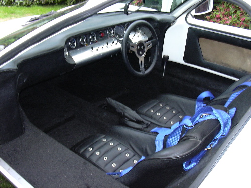

Paul
For SVA
Take a sheet of Ali
Cut it to the length of the switch panel
Bend it to fit around the dash shape and screw it in place of the normal removable panel
Then squeeze all the swithces together near the steering wheel - it is an exempt area and no need for changes to switches.
Sticker up with Dymo tape so he can read what switch and what light does what as they will now not line up.
It may look crappy but it's only for the jobsworth!
After SVA change back to the oriiginal cover and switch spacing and send your ali piece to Huw for his test.
Unless the car has electric mirrors leave the windows out so he can adjust the mirrors.
With no windows you can also tape the aircon switches out the way behind the dash for the test.
Pic attached of my car in SVA set up
