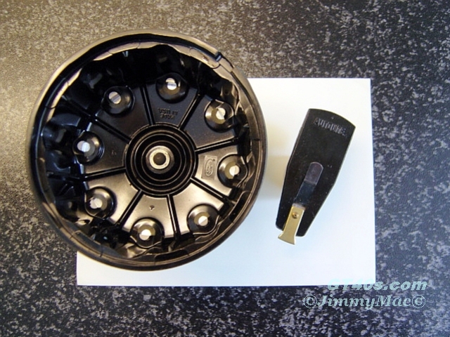

Re: Distributor Parts
Peter,
The cap and rotor are standard Fomoco & Autolite V8 parts for the period.
You can get the cheaper Motorcraft stuff readily.
I can't answer for the coil as I'm concentrating upon dual point.
