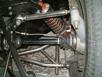

here are a few of pics of the mods I did to my car.
I moved the top link up, fabricated a new crossmember to hang the box from.
Removed the rear section of the chassis and fabricated an undertray and rear deck support frame.
The wishbones are scratch built, the uprights are GTD racing. Hope this helps.

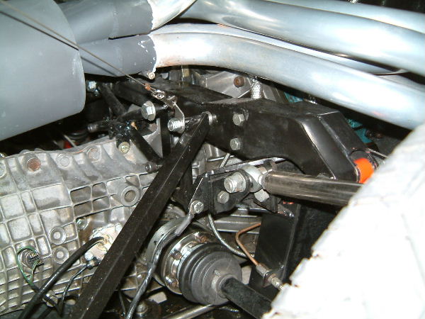

Another pic

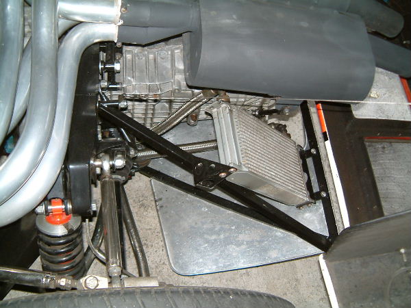

last pic!
