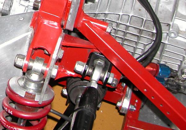

Hi Howard
On Roy Smart's GTD (and many others I believe), 0.5" - Regards Paul

Thank you Paul, One of C Smith's books says that on cars up to 2500 pounds we should use 1/2 grade 8 bolts to attach suspensions parts. So this is where I came up with 1/2" rodends. I just wanted to confirm my thinking with you guys over in England that have developed cars.
I'm going to start with this particular mount and link and continue with the rest as buget allows. I think I have found a sorce for poly bushings here in the USA that might work. I sent them a drawing and haven't gotten anything back yet. I want to mix bushings and rodends to add some compliance into the suspension attachments as this is mostly a road car on 17 inch wheels.
My ideas are to use poly bushing on the bottom A arms and rod ends on the top to provide adjustment at the rear along with rodends on both ends of the trailing arms .
On the front I am thinking poly bushings on the bottom A arms and a LH/RH center adjustable link in the middle of the upper arms along with poly bushings at the chassie or I may build new upper A arms with poly bushings at the chassis and a single rod end at the spindle like the orginal car.
Still working on body fit and prep so most of my buget for 2004 will be used for paint and my new BRM knockoffs. I will post some pictures of my new bolt on rear inboard upper link mount when I finish welding them next week.
Thanks again, your friend, Howard Jones
