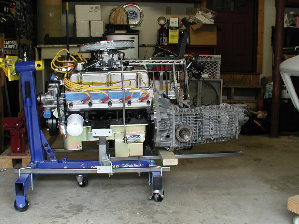

Somehow it just did not seem like we were building a car, until the Engine Factory sent this little number to our house, complete from air cleaner wingnut to oil drain plug. They built it just as I asked, then ran it up on a bench to check it out and tune her up. Even included a video of the engine running with a naration from the builder, good stuff.
Brian

Last time I saw that gearbox was in an xray machine and we were glad it had fifth gear!!!!
You may want to take off the angle plate under the carb and rotate it by 180 degrees and then ref it it. It is exaggerating the carb tilt not correcting it the way it is mounted at present. Gearbox tail is higher than engine nose when power plant fitted in car!

Malc - get your eyes tested - carb looks fine, gbox already tail high - I suspect filter is just 'resting' on top and not secured down to correct position. [img]/ubbthreads/images/graemlins/smirk.gif[/img]
