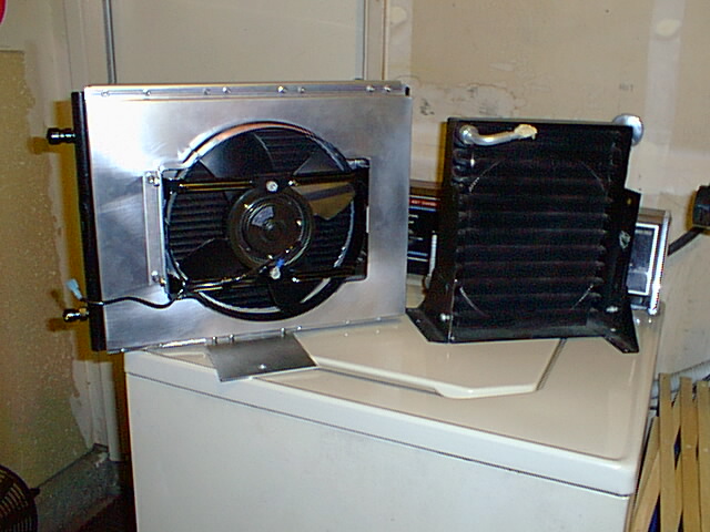

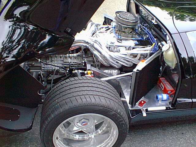

You can also add a larger AC condenser from Vintage Air. It cools better than my production car.

Here they are side by side
