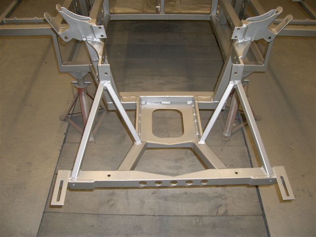

Re bracing the roll 'hoop' I fabricated a full cage out of 50mm CDS & took the roll bar rear stays to the top damper mounts. this was *alot* of work but will increase the safety as well as adding some stiffness to the chassis.
I've attatched a picture of the mods I made to my chassis. If I were to do it again, i would leave a bit more room around the rear of the gearbox.
Hope this helps.
