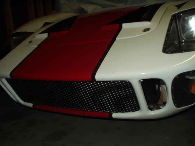

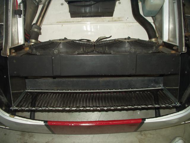

Heres one that was less than $50, made up of parts from the local hardware store
1- Porch screen door, cut out the grill mesh
2- lengths of 5/16" brake line
2- lengths of 1/4 allthread
2- lengths of 1"x1/8" flat stock
2- peices of polished stainless, from the scrap yard
4- nuts and 4 washers
Viola !

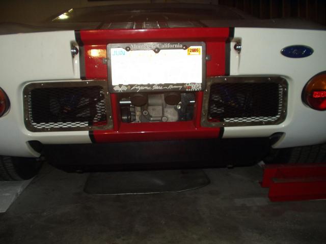

Here are the rears, that promote airflow out (exhaust) from the engine compartment, certainly better than the louvers. Again @ $50.
(note the rear view camera in the top, center of the license plate)
