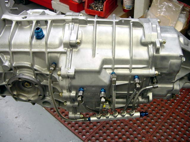

I have my R21 plumed, one return over the diff and the other over 5th gear. I have my oil cooler and my pump is in the mail. So I intend to filter the oil drawn from the drain hole through the pump and on to the cooler then back to the gearbox. This is the shortest route from the drain hole to the pump. Or I have been thinking if I place the pump after the cooler the oil temp will be lower and this must be better for the pump but the length of the system that the pump would need to draw through would be longer. Can I even draw though a cooler? I intend to mount just about the entire system below the oil level in the gearbox. I am using a Mocal type pump.
What do you guys think. Also where would I add a temp sensor? Can I put it in the fill hole and rely on oil splash to get a reading? If not where would/have you put your temp sensor? I do not want to add another bung on the cases.
What temps should I be looking for? I have a Quaife LSD.
Any pictures of your mounting system and location of pumps coolers etc. would be of help.
Thanks, Howard Jones

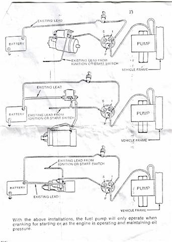

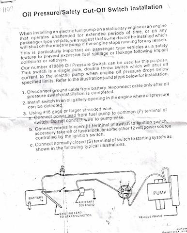

Howard, a sump pump is O K but is not a guarantee that you will keep the oil level set if you develop a leak. The level will stay there longer but eventually the level will drop if there is a big leak or a hose comes off, especially if the pump pulls from the bottom of the sump, which it shoud. You might consider a fuel level guage and sender to alert you to a low level. The fuel level guages that are offered from Pegasus and others do not use any moving parts and have a wire connection that will go to a low level light. Moroso also have several devices to warn of low oil pressure which can be plumed into the line. Here are some of the things mentioned. Several of these are wired into the ignition and will shut the ignition off if the oil pressure falls.

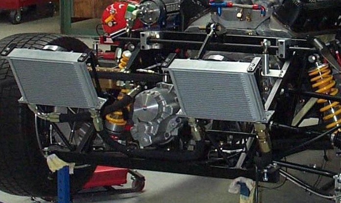

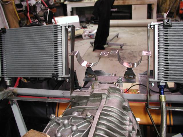

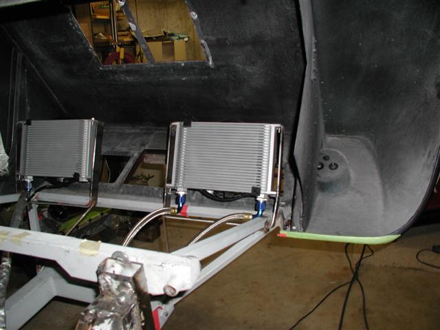

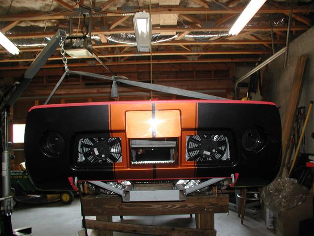

Howard,
That is the same cooler I am using. It has some big outlets and inlets. You will have to step it down somewhere along the line. I ordered mine large enough to fit the rear vents on either side of the exhaust. Am doing the oil that way as well. I am using the Mocal pump with mine. The spray bar setup can be had from Aircraft Spruce at:
Fittings from Aircraft Spruce
These may be a little small. They look like the same ones in the pic. You will find that the number of holes selected in the manifold is odd to the number you want. Either plug the extra one(s), or do like I plan, and that is to cool 2nd, 3rd, 4th, and R&P. First would not be used in any racing situation, hence not needed to cool. Of course you could always make your own.
There should be enough space for air to get to the coolers unless you have the rear bottom panelled. If you duct air up into the rear clip you may have a problem with too much air pressure under the clip. Easier to add a puller fan. That way you keep air pressure to a minimum. I am including a pic of how I set mine up, and one I had a pic of. Don't remember whos ride it belongs to. I am changing the orientation of the cooler to the lines at top. Solves all air problems. once the cooler is filled it will not affect the level of the oil in the box. If the two(box and cooler) were vented to air then you would have a situation that they would seek their own common level. Since the cooler isn't it is not a problem. Your storage tank if used could be mounted anywhere. Just make entry at the bottom and exit at the top. Circulate and top off the trans to whatever level you want. Just remember with the trans flipped it does affect the fill hole or full hole (whatever??)
