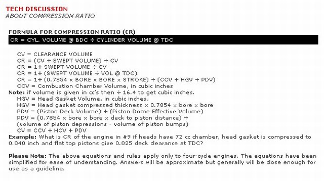

Commpression Ratio Formula
I can't take credit for this, I found it elsewhere.
