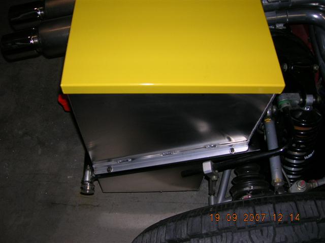

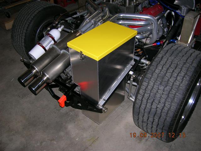

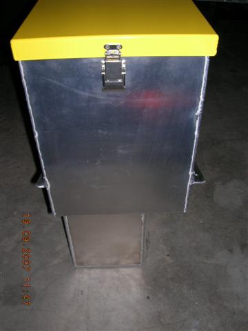

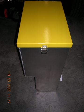

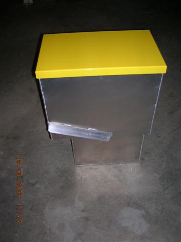

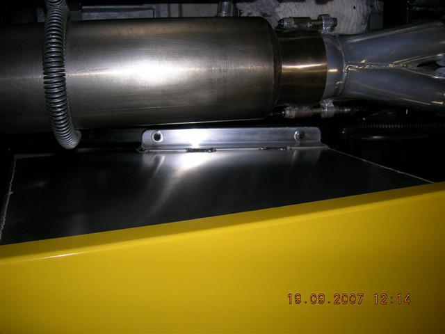

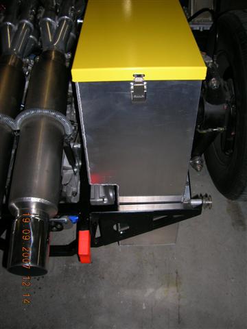

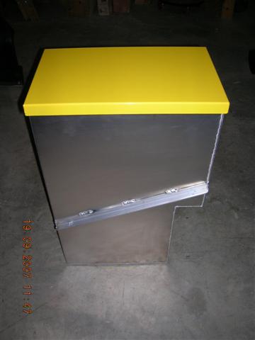

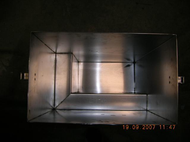

Below is a series of photos showing how to make up a luggage box for a SPF GT40 MKII. I don't give any dimensions because they would only apply to a MKII with small block engine and RBT ZF transmission. Every configuration would be slightly different. Also note that I made a box on the right side only. This is because my fire suppression gear is on the left. The “steps” on the bottom of the box allow for clearance of the shift linkage, shifter box and the lower A-Arm. Again, your application may be different so there is no point in supplying a drawing. This box is perfect for carrying a tool kit and other small items such as cleaning supplies.
