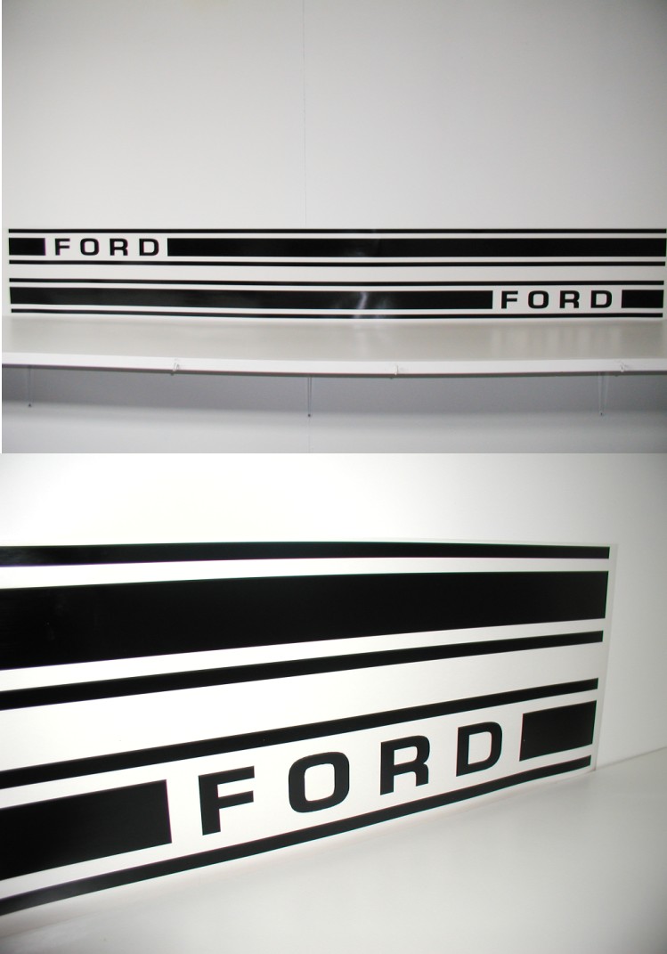

Mark is right, the sill stripes were all over the map. I put together my stripes with some info I believe was found on this site (might want to try a search) and by using this early pic as reference for the Ford font used.
Like this?
0.5 inch space form the top of the sill
0.5 inch stripe
0.5 inch space
2.0 inch stripe
0.5 inch space
0.5 inch stripe
If you're going to use a meatball, measure back from the front sill 4.5 inches. Use 1.0 inch space to start the FORD lettering, total length is 14.0 inches. The font I used had to be altered to get the correct look based on the photo.
Again, this is just a guide, not sure what is officially correct but this looks damm close!

Perfect! Exactly what I needed. Now if you can just give me the name of the font....looks like helvetica extended. or Futura?

Chris,
I am interested in a set of stripes.(the second example) in white.
How much are they?
Thanks,

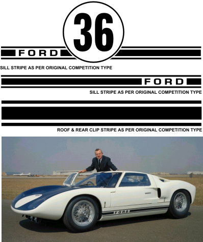

Hey Ron,
$30.00US for a pair + shipping.
FYI these will be manufactured using CAD software/digital cutting plotter. Material used is high gloss, 2.1 mil film and long life durability rating. It's also fuel and solvent proof.
It's not rocket science to apply but will come with what you need for the install, including an application guide.
I can also produce these in a digital paint mask, same principal for application. Just squeegee on, spray your paint, peel it off. Cuts masking time to nil and produces sharp, clean results.
Would this thread be worthy of others attention? Maybe under the Tech - Exterior forum?
Let me know.
Chris
Chris, send me a pair quick. I'll eventually paint but these will be a good mock up test
