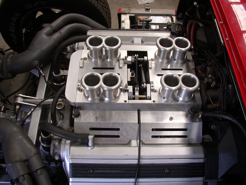

Old 04-25-06, 06:49 AM   #16 (permalink)
Join Date: Feb 2004
GT40: Newcastle NSW Australia
Posts: 60
Rep Power: 5 DAZPT is on a distinguished road
Re: Yet another N00b
I have a few pics of a RF with a lexus engine here is one.
DAZPT is offline

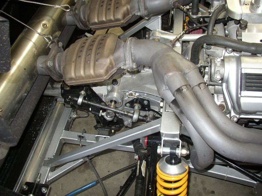

Old 04-25-06, 06:56 AM   #17 (permalink)
Join Date: Feb 2004
Posts: 60
And another I have driven this car it goes well and is so tractable your granny could drive it.
Darrell
DRB #46
G50 LS1

Very nice work with those ITB's and the exhaust system. Someone's certainly handy with a MIG/TIG box and a Bridgeport. What sort of EMS is the owner using? Do you have any performance figures on the engine and/or the car?
John

The builder of the car has a engine reconditioning shop on the NSW central coast and is a toolmaker by trade he made the exhaust and throttle bodies himself. The ECU is a Microtec out of Sydney.
