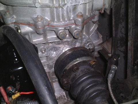

I have a 40 at work that is running a 915.
It is behind a 350chev the owner is not kind to it but it seems to have stood the test of time.
Russel this car has had the crown wheel swaped and the trans flipped.
It has had a lot of welding work on one side of the diff housing so I would say something didnt fit.
The other thing is the detents for the gate shift is in the gearstick on a porch(or porsche).
The detent springs have to be done externaly but aparently someone in the USA does a gate mod (internal) for these boxes.
The owner has sorced one I can ask if you like.
But you may have already solved this issue.

Thanks for the reply Jim . All the info that I have found on the 915 transaxle shows that it is more than strong enough for my engine as its rated up to 450 hp . The problem I have is that I am trying to avoid flipping the transaxle because of height issues with axle shafts. If I did flip it I would have to do modifications to chassis rails and suspension (added costs) also then would have to re-certify the car and that would cause more work to comply with current certification requirements .
I shouldn't have a problem with gear shift or linkages as I will be modifing the current VW set up.
I have emailed Renegade Hybrids and hopefully they will be able to answer my questions .

Jim, I think that if you flip the trans there is no need to swap the crown wheel. Maybe the welding is for something else......
Russell, Trevor is running his motor high, so has not flipped the trans so must have swapped the crownwheel. Give him a ring I'm sure he'll tell you what's involved.

I had to go into wotk and I took a closer look at that 915 trans.
It hasnt been fliped over but like I said a lot of welding has been done on the case (diff housing) .
Its all the way around not like it had a let go its like its had a major mod for clearance.

Thanks for that Jim , any chance of some pictures ?
Russ have contacted Trevor Crowe , confirms that his 915 wasn't flipped and crown wheel was swapped over . Only differences were that his was from SC model 78-82 series ? Not sure what that means , looks like will have to search the net for the info.
Lynn have sent an email to Bob Williams , thanks , will see what he has to say. Meanwhile of to do some more research...

So... Did he have to weld anything? I can't imagine Trevor going to that sort of trouble.......He's a pretty switched on fella, my impression is that he always finds the simple solution......

No , no welding involved... but his was a later version ... doing some research digging on mine ... so far, magnesium casing ... about 12lbs lighter than later ali ones ... just can't find decent enough pictures to determine if the casings are different in shape.

I dont know the reason for this.Looks risky
You wanted a pic so here it is.

Hmmmm. Not very pretty. Hard to tell from the photo but looks more like gluing broken pieces together rather than a nice even build up to allow internal machining.
