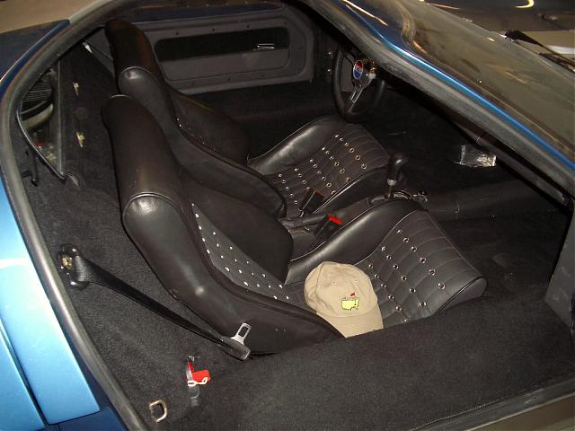

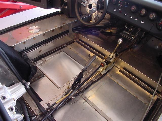

The too forward and cramped driving position in my CAV mono was easy to fix in three steps. What I did may also work for a CAV space frame car.
The seat itself was improved by a series of small adjustments. A drop floor is easy to add as shown in the attached picture. The CAV mono has “tube spacers or standoffs” that support the seat adjustment rails. They can be shortened 1/2” to lower the seat and give the preferred seat back angle. (The adjustment rails can also be eliminated and the seat mounted directly to the floorboard like Howard said.)
Inside the seat bottom, the left and right side 90 degree square edges can be beveled or bent or flattened to 45 degrees which lets the driver sit lower inside the seat bottom frame itself. The seat bottom and seat back padding can easily be replaced with a thinner high density foam to gain another 1/2”. On my car I also raised and widened the sides of the seat about 8 inches. If this was a track only car I would have also raised the edges of the seat for more hip and shoulder support but that makes the car too hard to enter and exit for most people.
I used closed cell foam and did trial and error shaping until it felt right, and then re-upholstered. The tricky part was making it ok for small women and large men. (Or small men and large women not to be sexist.) I went back and forth trying the seat and then shaving the foam thickness a little bit more each time until it felt right for several sizes of test subjects (actually employees who happened to be in the warehouse). The "butt" foam is soft and you sink into the cushion while the side foam does not compress much.

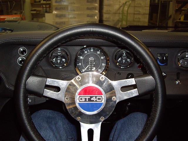

The steer wheel was raised 1 inch by just shorting the bracket under the dash and making a small clearance cutout in the fiberglass under the center mounted tachometer. On mono cars this adjustment lets the driver see more of the gauges through the center of the steering wheel and gets your elbows free and clear of your body.
The stock pedal assembly, which already has fore and aft position holes, was moved an additional 2 inches farther back towards the rear of the car so the driver seat could also be farther back. I am 6’ tall and I keep the seat adjusted back almost touching the engine cover bulkhead.
Overall the seating position feels real secure and DRAMATICALLY change the experience of driving the car. These changes also have other safety advantages. The driver's body is better supported by the sides of the seat. The driver sits farther back in the car away from the dash, windshield, and steering column. The driver's feet are moved farther back behind the line of the front tires. All three changes make for a more comfortable driving position, easier entry and exit, and less venerability in the event of a front end shunt.
