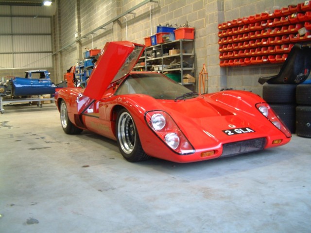

This is Nigels M6 in our w/shop early last year.http://www.gt40s.com/forum/attachmen...1&d=1171318265
We also prep his T70.
Darren
