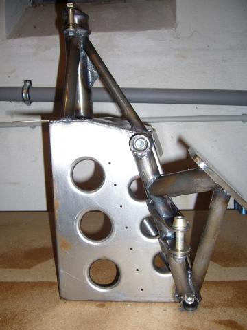

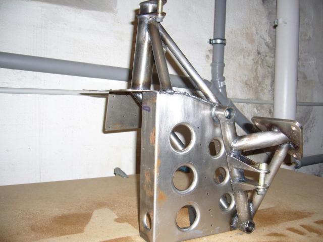

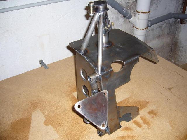

Some progress to report here.
While examining the panels and workshop notes of the motor mount bulkheads they turned out to be a very complicated part upon which a lot of the chassis´s strength and safety hinges.
Lots of different angles etc. involved and they also carry the rear rod towers.
So I decided to have them done by a reputed Lola specialist who has not been doing this for the first time. He is a master chassis builder, located in Simi Valley. CA. His name is John Mason and you can find him under
Mason Engineering - About
The bulkheads are in the making and are soon to be shipped, here are some pictures:

Steve,
thank you. The credits for the bulkheads all have to go to John Mason.
Since the finished bulkheads arrived yesterday at my doorstep in a crate together with many other bits and pieces I´ll post detail pics of all the stuff tonight.
Best,
Marcus

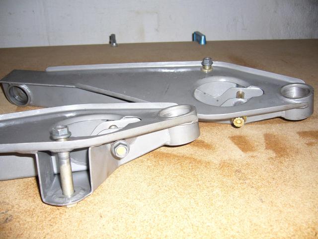

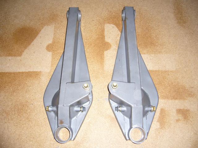

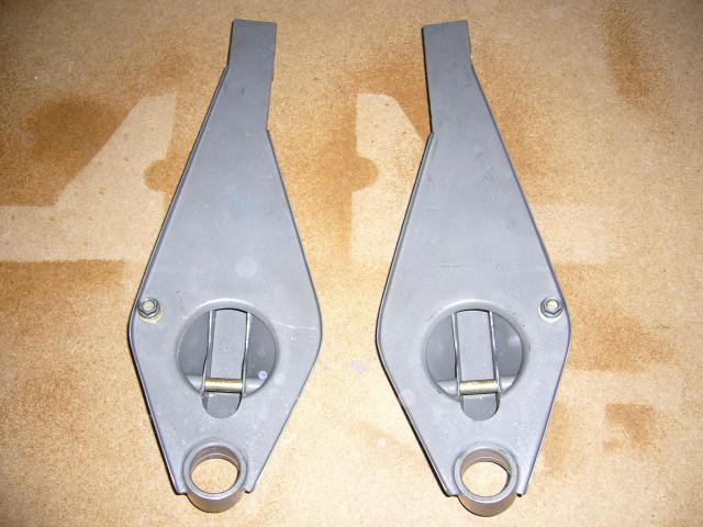

Some pics of the front lower control arms:
