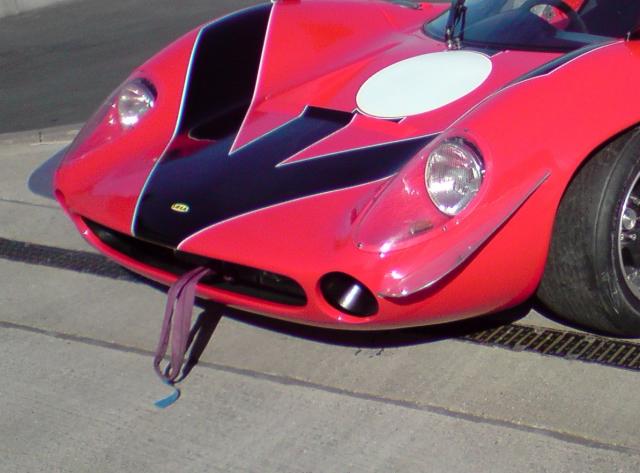

The towing eye looks fragile, but the bottom diagonals attach to metal straps riveted to the radiator supports and the vertical diagonal (you know what I mean !) just locates the eye.
pulling on the eye actually pushes on the radiator so long as the tow rope has an approach angle. This towing eye is NOT used for towing or loading or strapping down the car. It would not do well with repeated lateral forces. We use the roll bar for towing and loading. With the nose in place it is hidden, but with the nose off for tech inspections, it is visible..

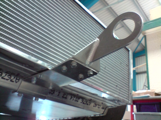

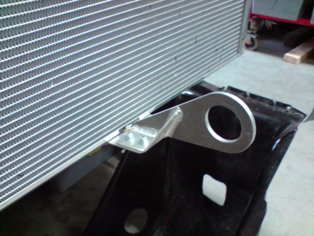

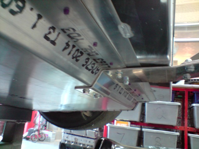

Here are a couple of pics of the eye we use. It bolts up through the bottom of the nose box just behind the rad. Sits just inside the nose opening and is almost unseen, and strong enough to winch the car into the trailer by.

Nice work Darren. Did you notice the old fans from a fridge that we had to work around ? I like your system better...

they are rheostatically controlled with a "frigidaire" knob thingy and they are from the late 1970s when AC was installed. They are not visible in this picture, as they are on the other side of the radiator. I plan to move them back to that location or remove them for racing. they are not needed on a track, but are handy in traffic or the pits...
