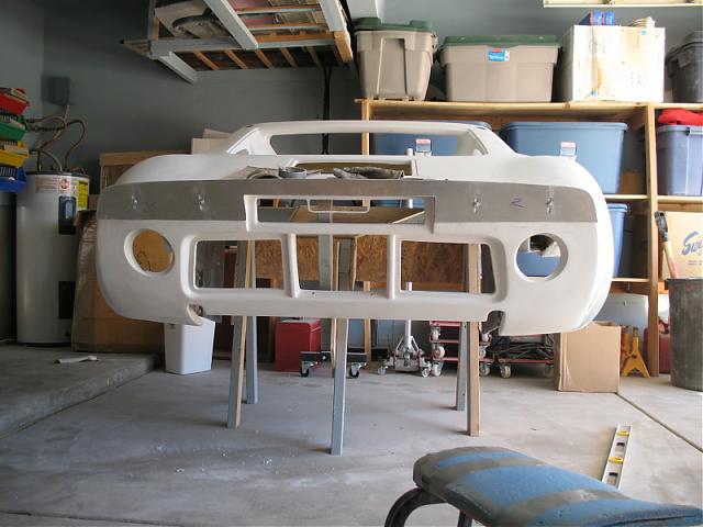

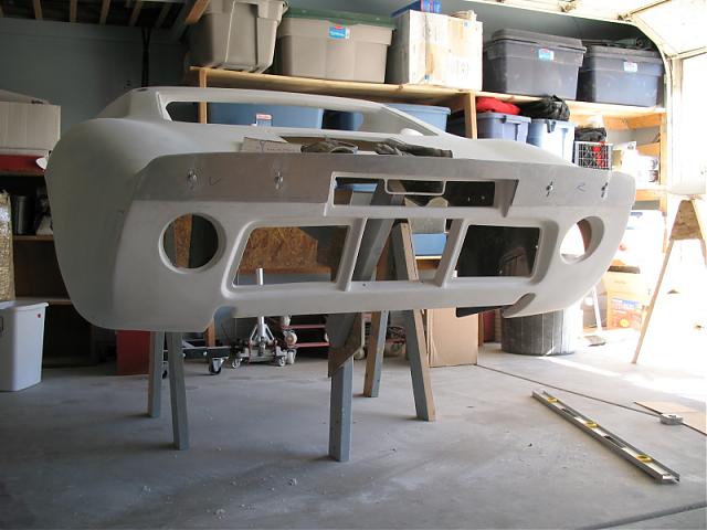

It's SUPER simple- after getting jealous of how some others' cars looked I bucked up and did one myself.
http://www.gt40s.com/forum/attachmen...3&d=1204350880
http://www.gt40s.com/forum/attachmen...2&d=1204350713
A couple of thoughts:
Be very accurate with your markings for the holes, specifically transferring them between the car and the metal sheet. Obviously you want them to line up.
If you're careful with it you can cut the shape out with a sabre saw or Sawsall using the appropriate blade (available at any home/hardware store).
I used a Dremel tool to elongate the slots after drilling the ends with the appropriate sized bit and then filed them to get them straight and square to the eye.
A CNC'd product would be "perfect" but this one is going to work out just fine for me.
Best of luck with yours!
