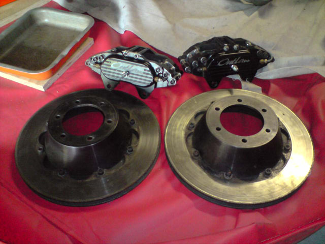

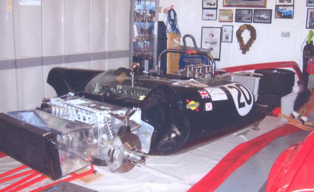

Hey Guys, Good news the Girlings have arrived and discs/hubs are all lovely and machined (forgot to take piccy today, will do I promise) and being fitted this week. What do I do with the 'as new' Outlaw brakes and vented discs? Where on earth do you sell T70 bits likes these?
ID:	34146   Click image for larger version

The Rotors & Calipers could be used on just about any project, GT 40 or otherwise by someone with enough ability to make caliper brackets if reqd, & buy the appropriate hats for the rotors. The Rotor Hats you have will be somewhat limited in application.

How much do you want for them ? I want to buy something from the UK whilst the exchange rate is still decent !

I have no idea what there worth, do you want the calipers as well, I would think the 4 of these must be worth 500 pounds, mine for my delta cost 1950pounds for the front two calipers (tarox 10 pots). make me an offer I suppose !! I will call my man fred who sold us the car and ask what he recons.

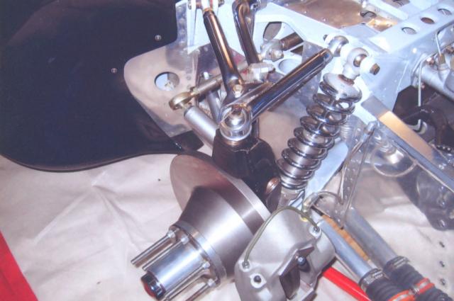

Can you post pictures of your new brakes before you install them ?

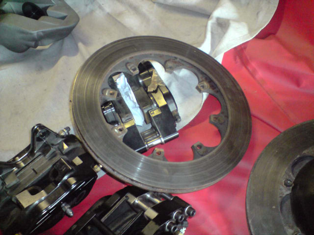

Hi, the rear calipers will arrive monday now, so only pics of the front set and sorry , forgot to take piccy before ! There a little blurred, sorry.
P.S 4 x vented Discs and 4 x Outlaw brakes, all for 500pounds if that sounds good. Let me know
