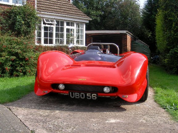

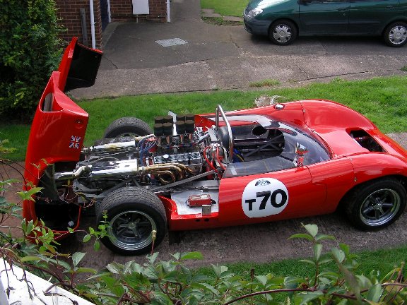

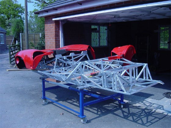

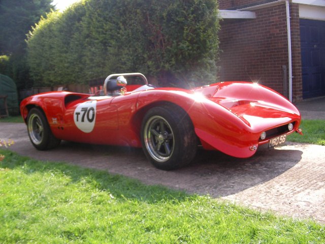

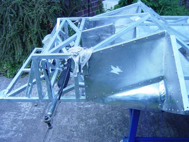

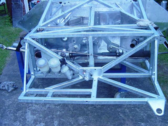

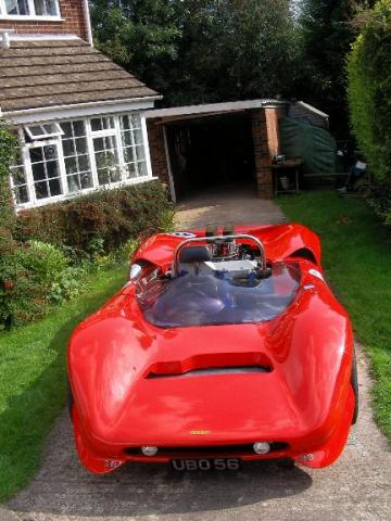

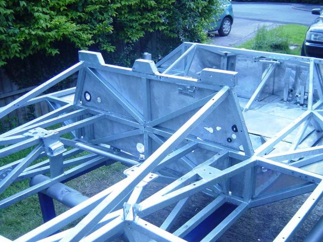

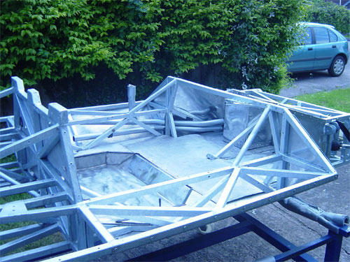

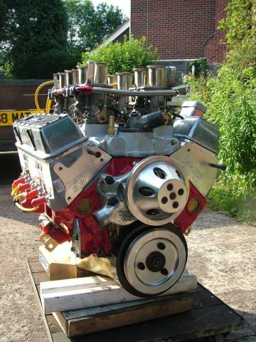

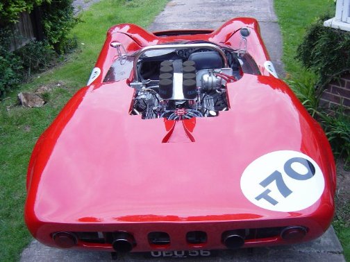

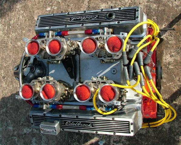

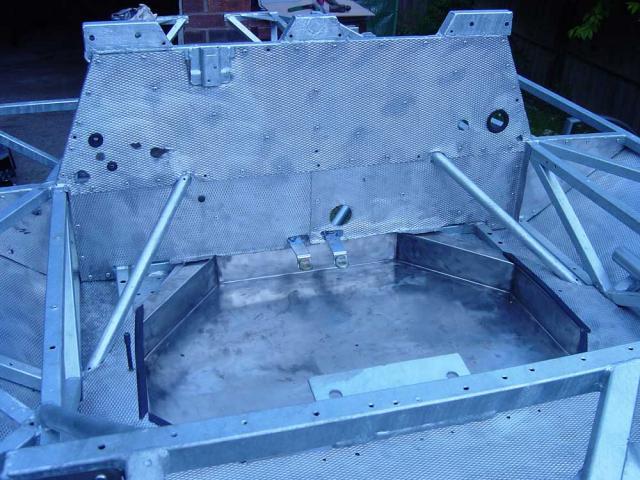

Thought it was about time i posted a few pictures of my rebuild. The car is an original 1967 T70 mk3 bodyshell with a space frame chassis road registered as a 1971 T70 special. It has a 406 SBC pushing out close to 500bhp @ 520Lbs torque using a G50 gearbox, rear uprights are Ultima front TVR Cerbera with AP brakes all round. (sorry will only let me load one image at the moment!!)
