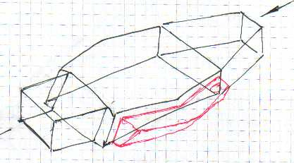

Anybody have any ideas for a retrofitted, more crash proof front end? There has to be a way to deflect the front wheel to tank impact. I know that the new GT doesn't have sill tanks, but has there ever been a car built with sill tanks, that has some sort of adequate tank protection? I could live with a couple of hundred extra pounds, if it would save my life. You'd need an entire fire department to put out a fire from that much fuel catching ablaze. Even with fire extinguishers and foam filled tanks, you'd still have a major problem, in such a crash.

All good points, safety, fire system, etc, but I was thinking along the lines of somehow deflecting the front wheels outward, so they didn't crush the tanks. That wouldn't help your legs much, but you might not become well done bacon. Perhaps angling the rear of the wheelwells?

That's exactly what I was suggesting. Not adding crumple zones or massive intrusion beams,
but diverting the front wheels outboard, in the event of a front end collision.
In theory, that would give you a couple of more feet of
crunch zone, before anything began pushing on the tanks.
Granted, there's not much in that crunch zone to slow things down,
just curious if anybody had an opinion as to whether that would make a positive or
negative influence on fire potential.

Wouldn't the steel plate just be a more solid object pushing on the tank? If a plate were angled 45 degrees
outward toward the rear of the wheelwell, a collision might take the wheel right off, but the plate might also lessen the wheel's impact on the tanks. The wheels would give the tanks a "glancing blow", rather than a direct hit. My 0.02.
Mike, I don't think the concern is puncture of the fuel tank, rather it is compression of them which causes the fuel to "hydraulic" and find the path of least resistence out of the tank. In a replica, this is likely to be the filler necks. One of the things I'm doing to my RF is to put some additional aluminum paneling inboard of the filler necks in an effort to keep fuel out of the cockpit. I will also fit an extinguisher system.
Another consideration is how a space-frame would compare to a monocoque in a crash test. My RF has a fair amount of chassis rails between the back of the front wheel well and the front of the fuel tanks. I suspect the space-frame chassis may behave better in a frontal impact, at least in terms of protecting the fuel tanks.
