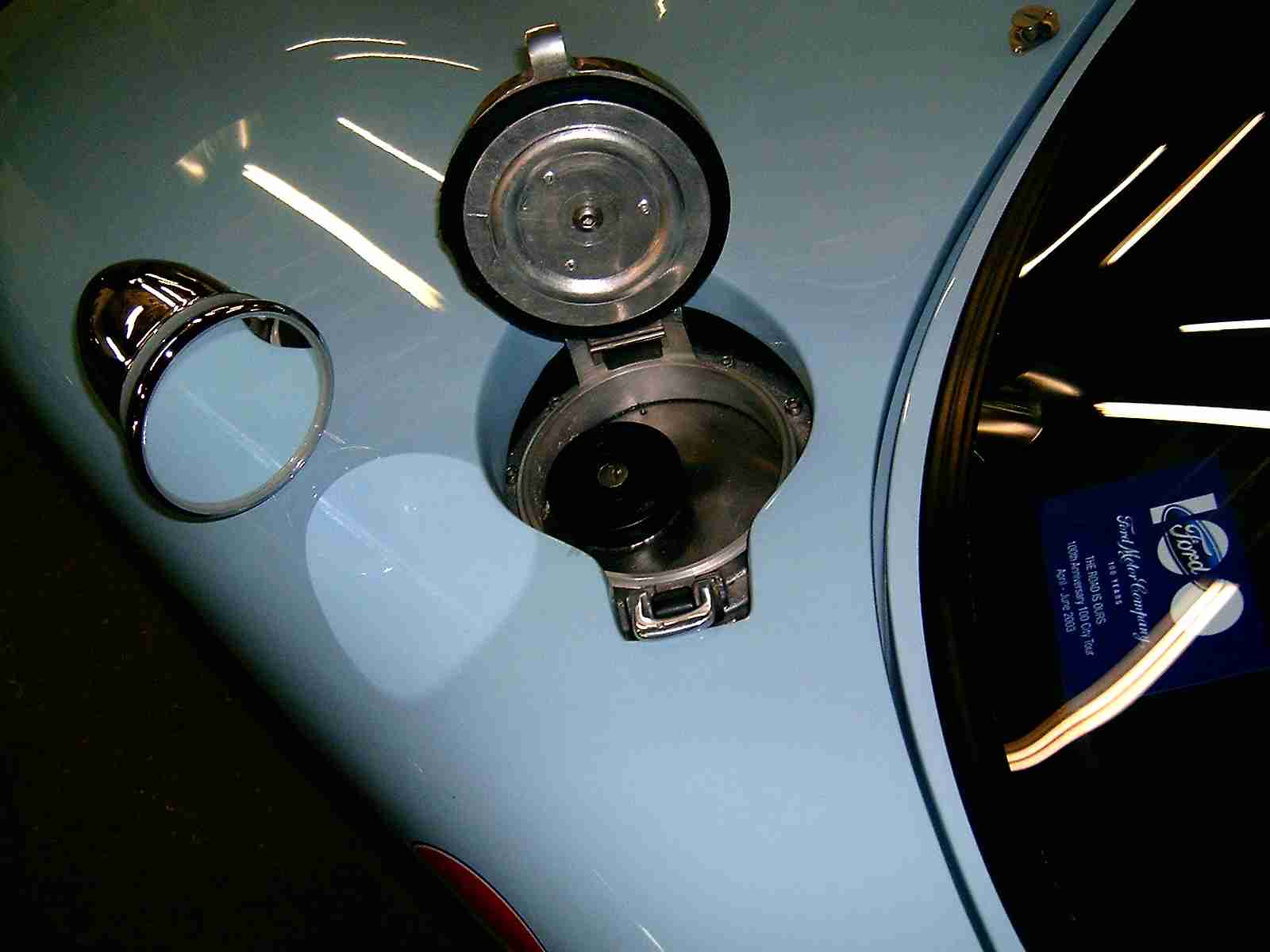

Nothing like some scary crash test pictures to make your consider your mortality. Racing in the sixties was much more dangerous than today.
Now the cars, circuits, marshals, support staff and medical attention are all superior.
However, on the street in your GT40 as J6 said it's worth driving very carefully.
On the matter of how cars are built today, the CAV monocoques are fitted with foam filled bladder tanks from the factory.
We have fitted all Canadian cars with locking gas caps under the Monza quick fill units and have recently added a fuel tank vapour return system with a purge valve and charcoal canister to our customer cars.
There is more to do and as we move towards building race eligible cars further modifications in the intrest of safety will be incorporated.
Although it's a little thing, one good bit of advice is: Always Carry a Fire Extinguisher on Board. And another favourite: Drive safe and keep it shiney side up

The locking cap is available from CAV Canada as a retrofit. It involves some machined parts and the caps themselves. The parts will fit all CAV monocoque chassis.
The caps are vented one way to prevent cavitation of the bladder tanks. A sealed system can create a vacumm as the fuel is used and can produce some positve pressure after spirited driving or experiencing an increase in ambient temperature since filling.
I recommend the gas tank vapour return system be fitted at the same time to keep pressure in the tanks at atmospheric.
