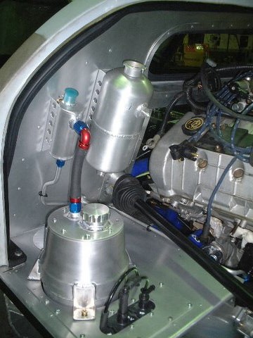

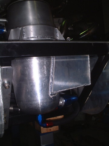

I put mine in the rear moved the battery to the front.
I wanted shorter hoses.
Jim

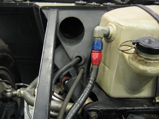

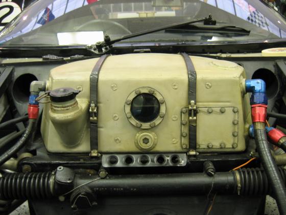

I found these, if I have these you may also but I hope they help.

Richard, thank you, thats what I was looking for, and thank you guys for all of your replies, Frank

Glad I could help. Do you know how to replacate the greenish coating?

It could be a green chromate alodine finish.
