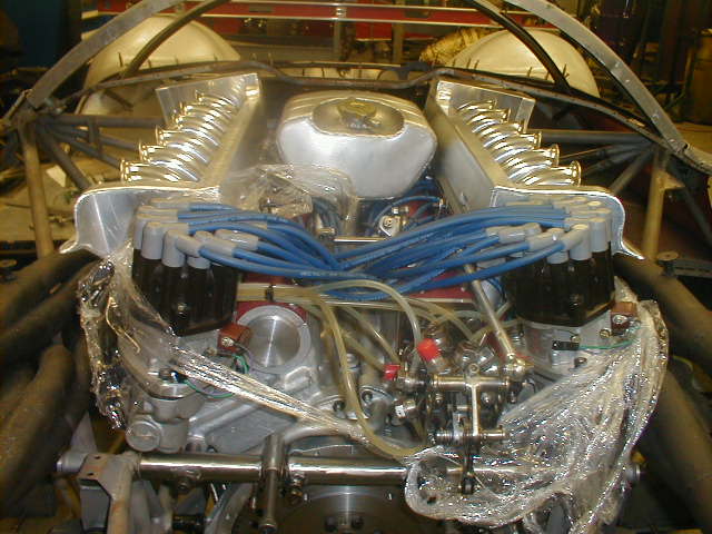

917 was a take-no-prisoners machine that was extreme even among prototypes. Not an easy car to control. I particularly liked the oil routed to the coolers through the frame itself. I doubt any replica would have THAT feature...

The water and oil flow through chassis tubes in my P4 which is a 66.

Many race cars of that period ran oil through chassis tubes,including 917s; but not all. Chassis flex and cabin heat problems led to the Wyer/Gulf cars running seperate pipes for safety and this is what i,ve done with my 917.
Modern racing regulations, certainly in GB, do not allow any fluids to run through chassis members for obvious crash safety reasons even if they are run in seperate pipes within the chassis tube, so do be carefull if you are building your 40 with circuit racing in mind not to have your front to rear water pipes running through spaceframe members.

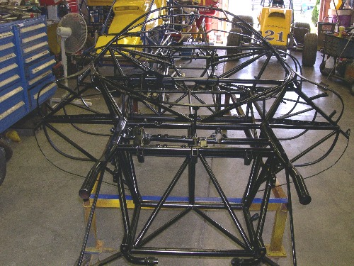

As in the Ferrari 66 P4?

That's my car. 0846. (The full sized one)
