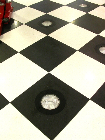

Rob's anchor points are brilliant! I'd consider a grid system of these throughout and maybe even cutting the grid dimension in half around the perimeter for, in addition to the uses already cited, bolting down machine tools and tool stands and work tables/shelves. This would be way more versatile than dedicated tool benches, especially if they had jackable casters on them. I love it! I had, at one time, considered pipes sunk into the floor, but Rob's idea is even better by giving stability in three dimensions.

Ron, To Lynns comments I did the grid layout on the floor. My only regret is I could have used three times as many. They have turned out to be kinda like wall outlets. Just can't have enough of em.

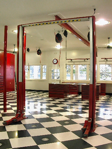

Recess the lift into the floor so that any low ground clearance cars can get on the lift. I can get full lift on mine with an internal max ceiling height (pitched roof) of 12ft and with the rear deck fully open. The recess I used was 9 inches.
Also try and get a copy of the lift installation drawings before you pour the slab so that you can get the foundations right. Saves risking a cracked floor later on when you lift a heavy car.

Ron,
I would mount lights in the floor under where you plan to install the lift. Makes seeing the underside easier.
