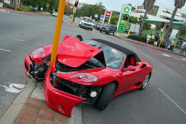

When I saw this I though "just another Ferrari wreck" but it got me thinking about frontal crash resistance in a rear engine car. This Ferrari's "deformable" structure is all but used up but it looks as if the drivers legs would have been 'A OK' as the impact s to the right of centre in this left hooker.
I don't know what the speeds were at, nor can I guess form the photo (no skid marks) but it may have been slower than you think as there seems to be minimal damage to the light pole.
With Ferrari presumably putting a high emphasis on safety in the design of a high performance vehicle and having them subjected to rigorous crash testing, the amount of intrusion seems still quite shocking although I understand the basics of deformable safety cells.
It got me to thinking that I would be looking at the front (and side) of a '40 quite carefully to see what added protection could be engineered in without losing too much aesthetics/performance.
Just a thought......
Sorry Admin, the Paddock is clearly the wrong forum for this post.....please move if it warrants it. Thanks.....

There’s not a simple answer to your question. All new cars in Australia (and that includes newly registered GT40 replicas) must meet collision safety requirements so technically these cars are “safe enough”.
However, real world safety of any car can only be determined by doing a statistical analysis of collisions/injuries for a given model, and the statistics will often show that theory does not always meet real world. Many manufacturers have an arrangement with the emergency services and are called to a fatal collisions just so that the situation can be analyzed and lessons learnt for the subsequent models. This approach though is obviously unlikely to be applied to low volume cars such as GT40 replicas so we are left with making theoretical guesses.
A recent article in the local newspaper showed the methods that Holden adopted in determining collision safety. To get back to your original question, their studies showed that a majority of fatalities in the Holden Commodore did not occur as a result of a frontal impact, but as a result of a side impact collisions. So if we can apply that statistic to the GT40, in theory it should be a relatively safe car given the large distance between the driver and the outer-most point of the car door. This of course assumes however that the vehicle colliding with side of the GT40 will hit a solid part of the car and not simply ride over it.
But then there are also other factors that influence safety that have nothing to do with chassis design such as the inability to see a GT40 until it emerges from behind a parked car, or the ability to spend less time on the wrong side of the road in an overtaking maneuver... my favorite GT40 safety feature

Good points, all. I think it is to the credit of the majority of replicar makers that they have included some sort of side impact bars in their doors. It wasn't that long ago that steel in the doors was confined to the hinges and lock/stricker assemblies.

I think the shot of the Ferrari wreck is within the boundries to piss off the guys insurance company quite well.
You bring up a good point about shunts in a GT40 though.
Time for everyone to get their copy of the "Shelby GT40" out by Dave Friedman, and turn to pages 117-119, showing a frontal crash test on a Mk II GT40. What is going to always be in the back of my mind will be what happens if a person hits something solid, and the shunt pushes one or both wheels back into the fuel tanks? I know about the discussions about modern day fuel cells, and what they have over what was in place back in the early days.....but still, that's scary.

I was talking with some police accident investigators 2 weeks ago (they came to do a presentation to the bike club I belong to).
ABS means skid marks are rarely left (on the road anyway )
he mentioned that a lot of performance or competition cars fit items to add strength and remove flexing (strut braces, plated flitch panels, roll bars, etc) and then add carbon fibre or ABS body panels. This means the original built-in crush zones don't do their jobs any more. All the lightweight panels disintegrate, and the strong structure doesn't deform as intended, meaning the body often suffers greater G's than is good for you.
We asked about being trapped by legs etc. He said this did not happen often with competition cars, however internal injuries were very common due to the above. His comment was, crush your legs and you may live, possibly even keep your legs, but dislocate an organ and you will almost certainly die at the scene...

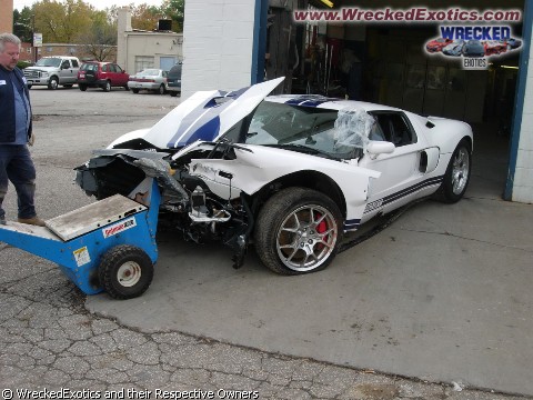

Following this I went to wreckedExotics.Com
Found this

Man....that's pretty much all used up as well.....

Re the original photo
Location: The Windsor Hotel, South Perth, Australia , December 2006
Car: 2004 Ferrari 360 Spyder
The driver apparently got drunk at a bar and decided to show off his car as he was leaving. He ended up crashing into a pole right in front of the bar. All the patrons were jeering and laughing at him after the crash.
To cause that much damage to a car, on a bright clear day, on a surburban intersection, with no other vechicles involved, he had to be doing something really stupid.

Lack of skid marks suggest ABS. ABS can do really wierd things when the car is sideways... they are only really designed to work in a straight line.
The Porsche Cup race cars had ABS until a few years ago. The crashes on the race track with those cars were scarey. Out of controll cars would dart off in all sorts of unpredicatble directions rather than skidding in a straight line.
