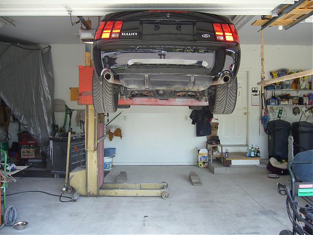

Here's a pic of the beast. It's essentially a pallet jack on lots of steroids. Lifts car to full height. Well...almost, I have to bend my knees just a little if I don't use the rubber blocks (spacers, seen in pic). I have lifted kit cars to 1/2 ton pickup trucks. One of the coolest features is that I can lift a car as high as about 1.5' off the ground then roll the unit around. So, I can transport imobile vehicles. Or, if I just decide I want to spin the car around because I working on the other side now and can't see the TV, I just grab the handle and spin it. Pretty cool.
Only giving positives.....here are some negs:
- Body of hoist makes it impossible to work on the one side of the car where the hoist is. i.e if you lift from drivers side, you can't work on the drivers door or open the drivers door.
- I can't fold it up and put it in the tool box when I'm done.
I will be using it this weekend (oil change on the stang), so will try to take a pic of it in action.

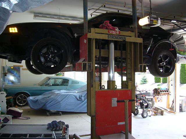

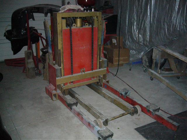

Here is my "Unic Strongman"
As mentioned, they are out of business, but worth grabbing if you can find one (IMHO).
