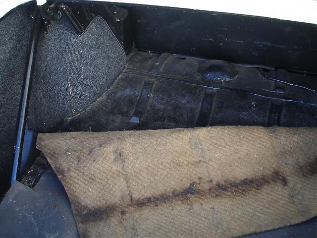

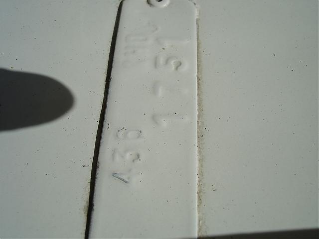

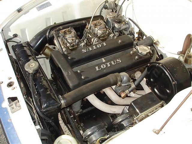

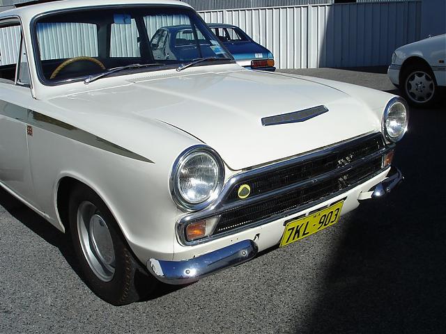

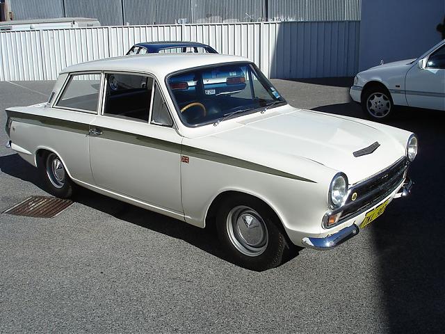

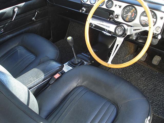

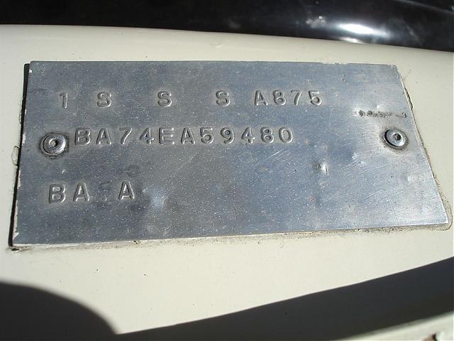

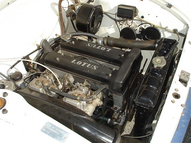

Hi I found this Lotus Cortina for sale and would value any opinion on it's authenticity. Below is the description I got from the seller and some photos.
Peter
Thanx for your enquiry .
This car was imported from Zimbabwe in 1989 , and has had one Perth enthusiast Ford owner since .
The car has been inspected by the local Lotus guru , and he has confirmed it's authenticity , the factory reinforcing bars in the boot , continue on behind the rear pillar , a sure sign that it's genuine , also the white painted plate under the bonnet attests to the fact that this is a RHD built 65 Lotus .
This car has had the rear A-frame replaced as with most Lotus cars , as the bad design fault incorprated in them caused the diff housing to flex , and either break or produce interminable oil leaks .
The factory mountings for the A frame are still in place , also the hump in the boot for the diff clearance is present .
The car is in excellent condition , as it has not been a race car here in Perth .
We would welcome any inspection .
Regards
ID:	20751   Click image for larger version
ID:	20752   Click image for larger version
ID:	20753   Click image for larger version

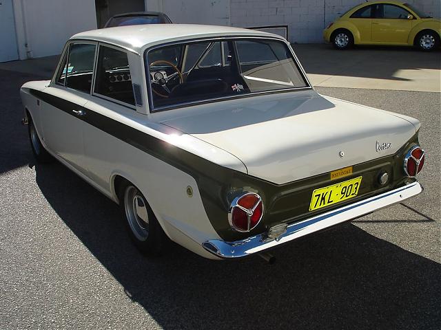

Rear view.

I forgot the bump.

I've only seen one in the flesh...many,many years ago and it was LHD of course. It appears to be genuine, but they are only pics. I would think that Lotus could authenticate the # if there is any question regarding real or not. Since I have worked on probably 20 various Lotii over the years, the fact I have only seen one of these makes be believe they were pretty limited.

Along with the alloy panels, the -Bell Housing- Gearbox extension housing-& Diff Head casting should also be alloy. You should definitely buy it Pete, after you set the tappets a couple of times- have fitted a Head gasket or two- welded up the head to get rid of the corrosion-paid the speeding fines because you wont be able to resist the sound of those side suckers- and then realise those green stripes are just cop bait you might at last ' see the light ' and start picking on the Poms who built this lovely motorcar so that you could pay many times its original price for 42 years later!
Hope that helps with the purchase decision!!

Thanks guys, you have made me laugh,and Ross and JacMac the magnet/alloy tips are good. Thanks. The problem is the thing is in Perth, a long way to fly to discover a clone.
Di reckons I have to many toys anyway. ............... Sheilas have no idea.

You say from Zimbabwe?
The only one I knew out there was owned by Gary Ainscough (Ex Frmula Atlantic fame) But his was stripped down track car with a full race BDA inside it.
But there was a rumour that Rob Rushforth also had one but he raced other cars. Before moving into rallying.
There were enough good metal workers out there that could have done any number of mods to the chassis and body and make it look good and pass for something that it was not.
Now the one good thing about Zimbabwe is that it is 300 mile from the closest sea o rust hould not be a problem
If you have the wx Zimbabwe owners name I could ask through the old network

Ian the owner in Zimbabwe was Bill Thomas who has passed away. I have decided not to go ahead with the car but it would be interesting to know if your old network has any knowledge of him.
