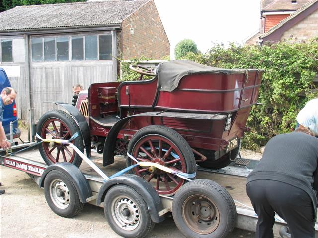

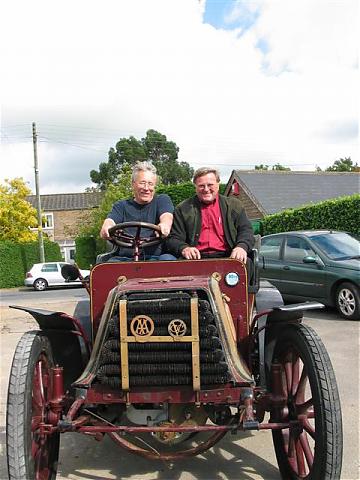

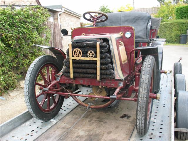

New kit on the market???
I went to england this weekend and picked up my stuff from john wisher and frank catt
And what did i see can it realy be true
Is frank going mad ?
Producing a new racing car without telling us !
what was he thinking
I've taken some sneeky shots

So how does Franks suspension fit to this chassis?
It looks a lot of fun though

Four weeks to the famous London to Brighton historic vehicle run, one 1898 ( 109 YEARS OLD ) Panhard Lavassor Race car, an engine delivered with the car in various boxes which last ran on the run in 1998 and seized through a water pump failure ( water pump runs via a wooden pulley that just rubs on the side of the flywheel ) Two flat tyres ( perished tubes ) and Entries paid for and accepted to this years run on the 4th November. No pressure then, most wearing parts are worn out and need replacing, no factory parts department ( factory closed down in 1900 something ) so we have to make everything, including the dreaded brass water pump, get it MOT tested, taxed and insured, run the engine in and get to London the day before the run for a special drive through the city. The car has a wooden chassis, wooden wheels, wooden brakes, four forward and four reverse gears, a decelarator pedal where you think the throttle is, and a piece of wire as the accelarator. Could be fun on the first drive to the MOT station. Frank

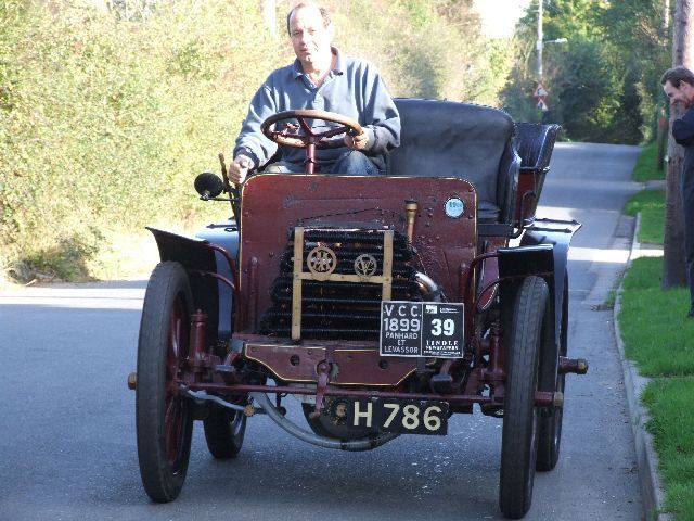

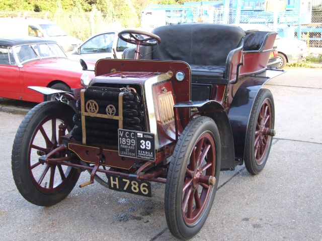

First drive and MOT test today. Big learning curve on 108 year old carburation and ignition systems, all of the controls are backwards from what we are used ( ie close throttle on carb to go faster !! / throttle pedal is a decelarator / the one brake lever similtaneously throws out the clutch and puts gearbox in nuetral, so hill starts without jumping off and putting a block under a wheel is impossible etc etc ) The guy at the test station was completely bemused, all he could do was walk round the car, kick the solid tyres and fill in what he could on the test sheet. With no lights, no windscreen or wipers, no brakes as such ( wooden blocks onto the wheels ) no anything that usually gets tested, he couldnt do much than sign us off and we got the approval. We still have a lot to do, but the Brighton run looks much more a possibility now. Frank
