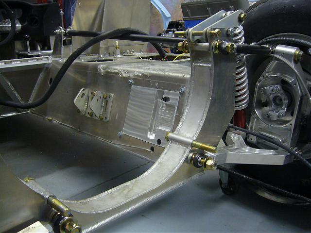

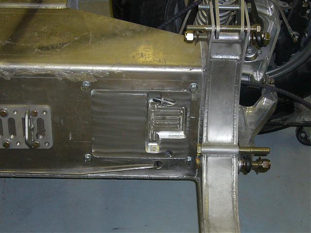

Hey Chris,
Actually the table size is the limiting factor, not the distance to the lather (usually). In a perfect world (i.e. one with lots of money falling from trees) I would have purchased a larger one, but for small shop projects it works great. So..nope, there is no machining cross members, but I machined this bell housing clearance plate with shift cable guides.
