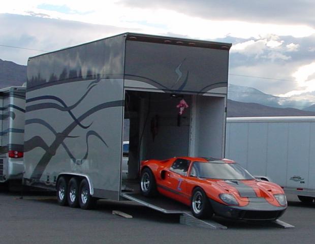

Re: Which winch ?
Bill,
Thanks. What you are saying makes a lot of sense. I will get a stronger winch that will also enable me to get a heavier car in the trailer as well.
Question : Do you pull your GT40 in back first ?
Thanks again to all for your help!

Re: Which winch ?
back first

Re: Which winch ?
Back or front on first all depends on your trailer.
The tow ball is designed to be at a certain weight on the tow vehicle and by putting the car in front ot backwards you can adjust this weight.
Likewise if you are also moving tyres etc where you place the racks will make a huge difference to the trailer nose load.
The biggest "no no" is to have a trailer that will lift the front when disconnected (too much rear weight)
By getting the weight distribution correct the trailer will also tow more easily and be less likely to sway.
Trial and error and a set of bathroom scales under the jockey wheel once and then marks made on the trailer for the future is what I suggest
