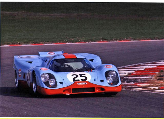

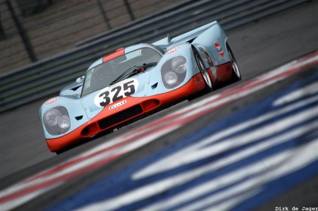

If anyone interested i found a couple more shots that are downloadable to this subject. I,ve loads more but they are all too large to send and i don,t know how to resize.
Anyway the head-on shot was taken at Spa by someone at, i assume, la source hairpin ??
Graham.

Just looking at these pictures just goes to show how very different the Powder Blue and Marigold Gulf livery can look in different light and with different photographers and filters.
I know that many moons ago i tried to explain the variations in different light and how impossible it is to get the "correct" colour !!!!!
Graham.
