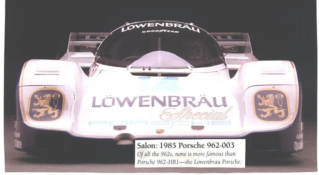

917s: Look pretty "advanced" to me at the time. Especially when one was driving a Ford Falcon......

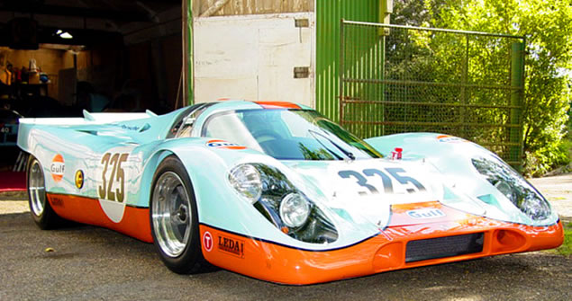

Gulf GT40
Looks hot, light, crazy fast, and most importantly the package worked (or got working). Took how many victories in it's hey day... A lot. The car, the team (engineering/ race support) and the drivers did a tremendous job to make the car a winner. The motor was a work of art as well, worked well to bring many wins. Chassis made of alloy, many advanced materials used in the engine, etc. Someone with a Porsche background could likely quantify it more. One thing that always amazed me about the car is watching it in races just walk over most cars of the era (If you can find some of the early races at Daytona with JWA Gulf team you can see what I'm talking about).

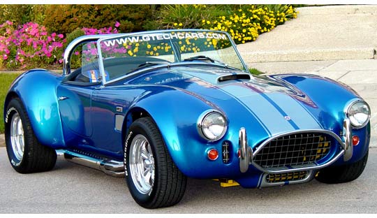

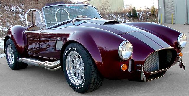

Look at the Cobra, a simple frame with a good motor, light, and some crazy Texan spanking many a red horsed cars, again, no engineering marvel, but the cars were worked into winners.
BTW I'll take the 917 over the Cobra :-)

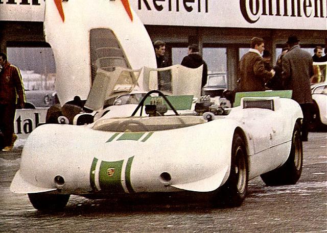

Think that period porsche was THE porsche..if u wanna look at something really innovative and fool..try look at the Porsche 909 Bergspyder..THAT is really a crazy car but nearly unknown cause done for hillclibs and secondary races(studied it..loved it at once..)
Porsche - Porsche 909 Bergspyder Overview
I am trying to found something about its costructive details,cause I have an article in italian that clearly shows the FOOLNESS they had in doing such ligh blast,but cant found anything so detailed on the net (Markus..u surely know..plz help me:D).
just to have an idea..to save weight they didnt use a fuel pump..but a baloon inside fuel tank...:D ,pushing outside fuel with its own pressure..LOL

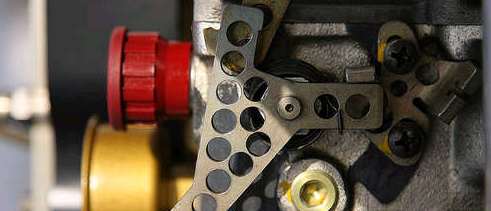

Paolo,
trying my best, hope not to be called a smart ass.....
The 909`s dry weight was in fact only 375 kg, 420 kg were that of its successor 910 Bergspyder.
Ferdinand Piech, by then already having a reputation of being obsessed with weight reduction, had ordered his engineers to apply as many trickery as possible:
The 909`s body was so thin that the mechanics were strictly forbidden to sit on any part of the car. The layers of paint on the car`s body were so thin that the paint had always been gone every time the car got washed after a race.
The springs were made of titanium (just like those of the 917).

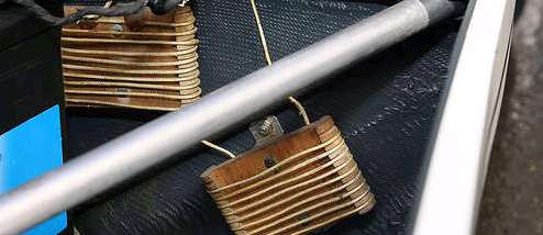

The ignition resistors were made of plywood.
But the 909`s most spectacular feature were its brakes:
The discs were made of Beryllium. Since this material is extremly toxic, Piech ordered to have the discs chromed.
Piech recalls:"That was sheer madness, since those discs had cost more than the whole rest of the car."
So they only had a set of five brake discs altogether which were always awarded to the car of the faster 909 driver.

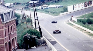

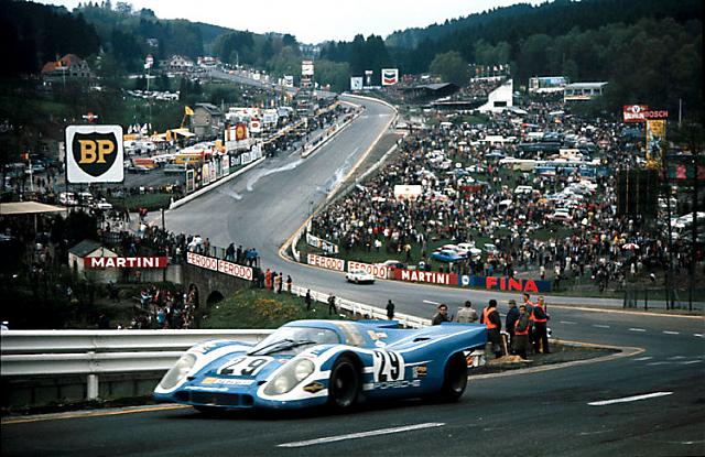

...just to remind all the guys what was 1970's Spa:D
If anybody of u likes Pc driving games..Grand Prix Legend has it inside. And that track is too nice and too fast;)

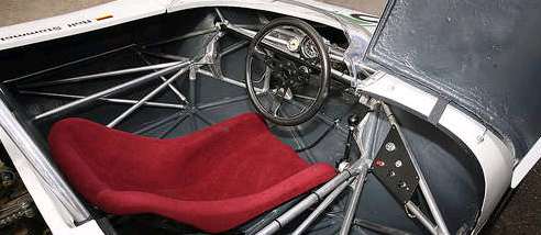

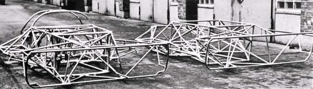

Also when I saw the 917 Langheck at Goodwood FoS a few years ago I was utterly shocked to see that it had no roll cage!! Only a fiberglass bulkhead!!! This car being the Porsche museums Martini painted car. Which in actual fact was an original Gulf chassised car.
Since in 1967 the MKIV Ford had a full roll cage and fire exstingusher system in all their Le Mans cars. Why would Porsche not fit a roll cage it would not have added that much weight to a car being driven for 24hours?
I hope I am wrong and they did fit roll cages in the Le Mans 917's!!!???

Not exactly what you would call a roll cage, but at least more than just a fibreglass bulkhead. Part of the frame was laminated into the bulkhead, see pics below of the chassis of two 69`cars.
