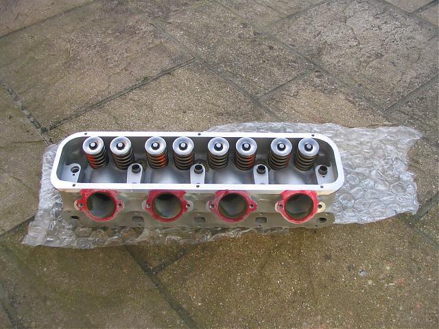

knighty 11th September 2007 11:55 AM
Re: Gurney Weslake Head performance
I'm not a GT40 nut, but have an interest in the Gurney-Weslake heads and their down-draught configuration, while googling around I noticed Knight Race engines also do a re-make of this legendary head......looks like they have done a good job to me, see the pics and info in the attached link.......nothing to do with me by the way, I can assure you I'm in no way related!
Knight Racing Services
I would be interested to know what sort of power anyone is are now making on a 305 (5 litre) block fitted with GW heads, last I heard was 520bhp???......which is over 100bhp per litre, which is pretty impressive, even today!.......
please forgive my ignorance, whats the bore and stroke of a 305 block?........also - whats the valve angle of the GW heads?

Can anyone tell me the valve angles these GW heads were set at…….it looks quite minimal, I'm guessing around the 12 degree region?
JIMMYMAC 27th September 2007 11:41 AM
Jay Cushman might be able to help you.
ranger jim 26th January 2012 09:02 PM
Gurney/Westlake were of course on the right track with their cylinder heads. The only deficiencies the had was they went with 2 valves instead of 4. The standard 80 degree V8 head cannot compare with GW heads. The only way to improve on the GW head is to go Cosworth. Replacement aftermarket heads offer only minor improvement. ranger jim
kazoom 26th January 2012 10:02 PM
Hi, an interesting note is Gurney and Weslake did make multi 3-4 valve pushrod heads for the sbf+sbc engines that made some very good power #'s.
