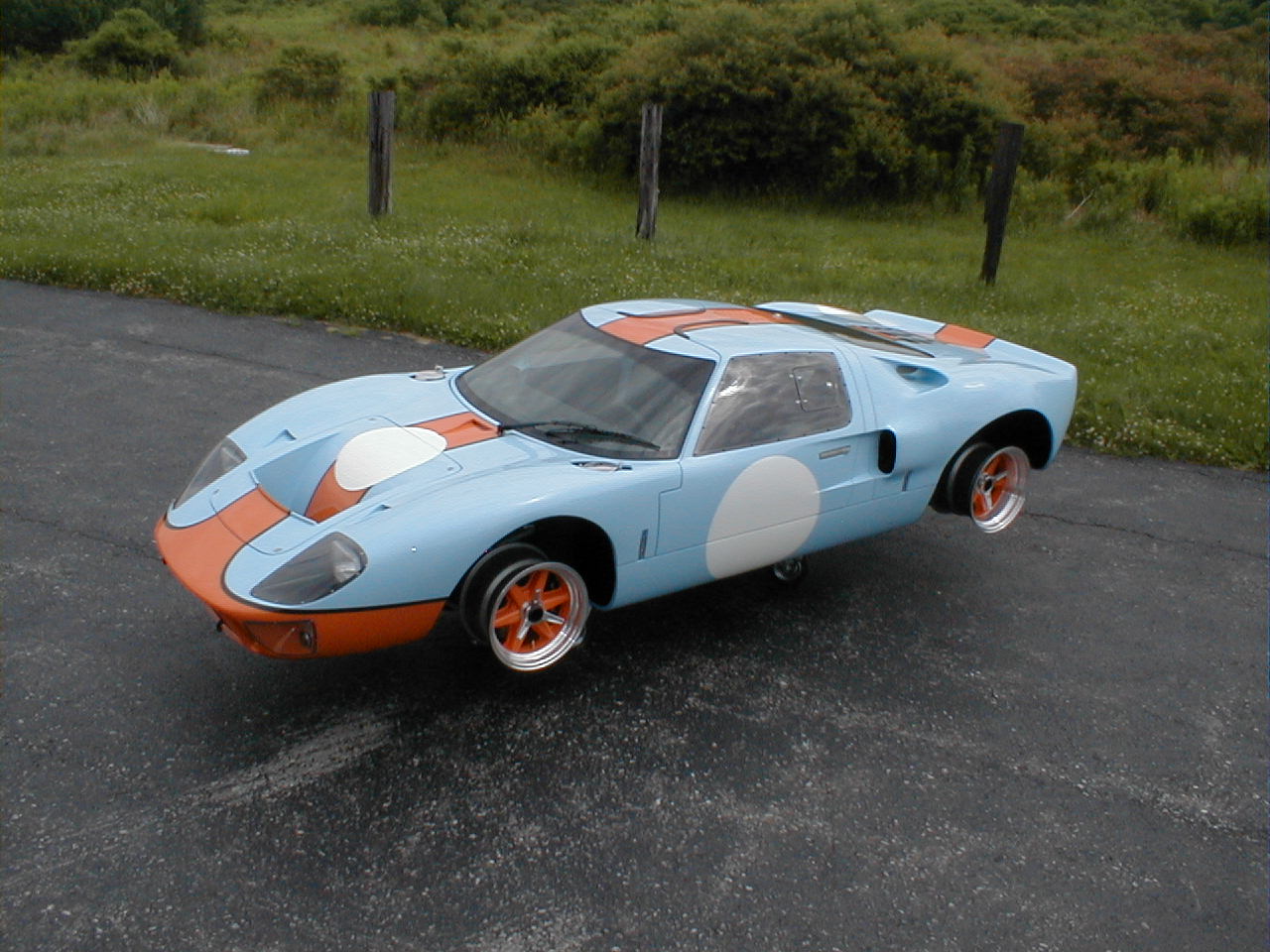

is that the difference between this>
and this?
both are here for more pictures

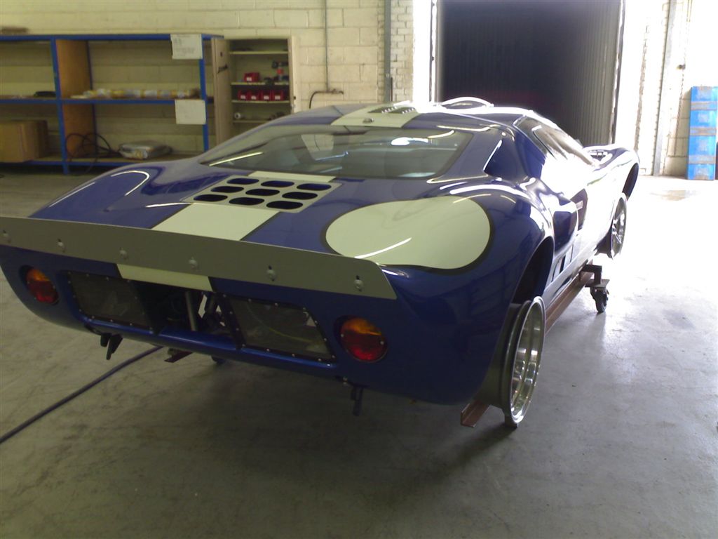

and this?

No,
The first picture (#40) appears to be a replica of some sort or a modified original and the second photo(#7) is the 1969 "Gulf" type tail which featured the flares in carbon fiber, the first use of CF in a racing car as we are told.
These pictures are the standard SPF "1968 "mid" width tail...
