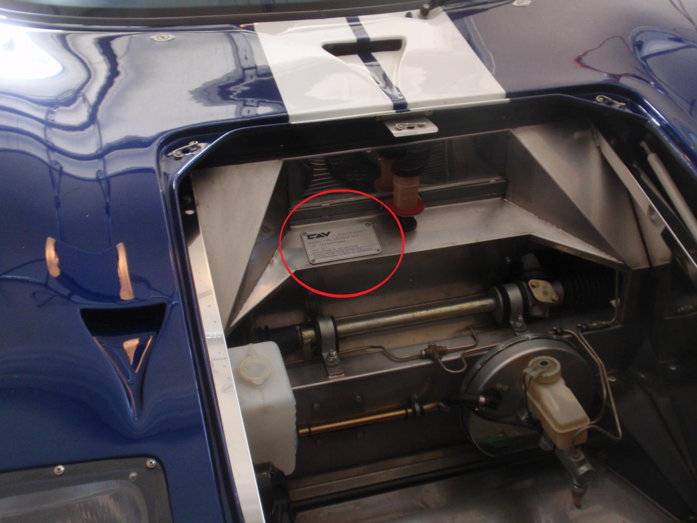

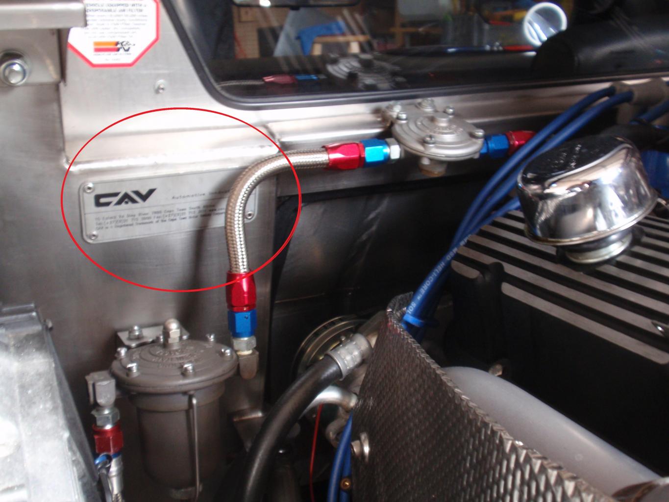

The CAV should have the VIN stamped on the left top shock mount and VIN tags on the front of the chassis and the left rear bulkhead.
Strange you seem to have a monocoque ID from CAV, but a space frame chassis......hhhhhhmmmmm.... Pics will definitely help solve the mystery.
That is one sturdy looking chassis and it definitely ain't a mono! Doesn't appear to be much of the CAV left in any event. Somebody may have been "creative" with chassis number for importation/registration purposes? Question is, who's is the chassis number? Why not contact CAV and have them assign a proper number and maybe even supply a plate? Or maybe even make your own number & plate. Not many DMV's seem to recognise kit car vin nos anyway.
Pat
I agree with Keith, that is not a CAV mono and doesn't appear that the number is appropriate for the chassis pictured. The 1A suggests a CAV built for the USA and it certainly isn't a mono. Perhaps CAV #74 met an untimely end and someone did a "restoration" from some of the bits to create your chassis. From the pictures it is really hard to tell. So it may be wise to verify the legality of your car before you invest heavily in it. Perhaps CAV Europe could help with the identification.
