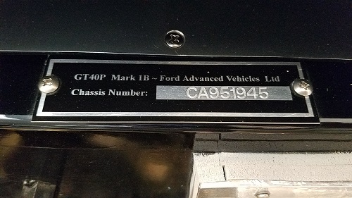

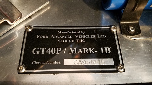

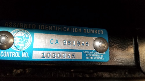

here are pictures of my vin plates.

That is a plate that someone has stamped and screwed on. The chassis number does not relate to GTD style numbering. The GTD chassis numbers are stamped into the thick square chassis tubes above the steering rack. They are quite often panelled over, The GTD chassis numbering system is as below.

In the mean time. That blue plate is the state of California's official plate that designates the government recognized VIN number. This is the official nationally recognized VIN number and is the only important one. Do not remove it or alter it in any way.
The other two black and gold ones are replicas of the original Ford advanced vehicle plates that we both got on line from somebody on this forum way back in the day because I for one thought they were cool. He liked them too I guess. They mean nothing really.

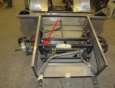

Here is a pic of the usual location of the chassis number on a GTD. I don't know but it may be on the other side on a left hand drive car.

Re: GTD40 chassis # help please
Thank you Mike I will go check on that today.
