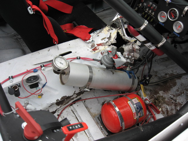

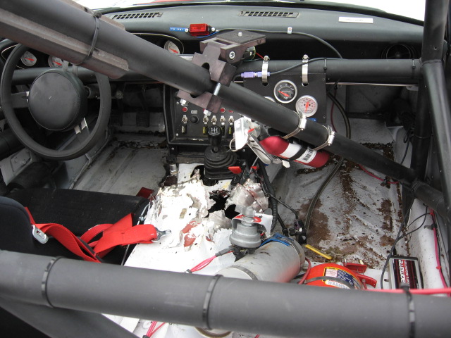

About the fifth or sixth lap around during the second session we had a fairly heinous failure. I came out of Oak Tree, a sharp right hander, and started down the 4000’ straight. There were no other cars around for about half a mile or so. At about 70mph and just a little ways down the straight, I heard a tremendous BANG!!!!! There was dirt (what I thought was dirt at the time) and debris flying all around the car with a lot of vibrations coursing through the chassis. There were various noises clanking and clunking so I figured maybe it’d be a good time to pull off track.

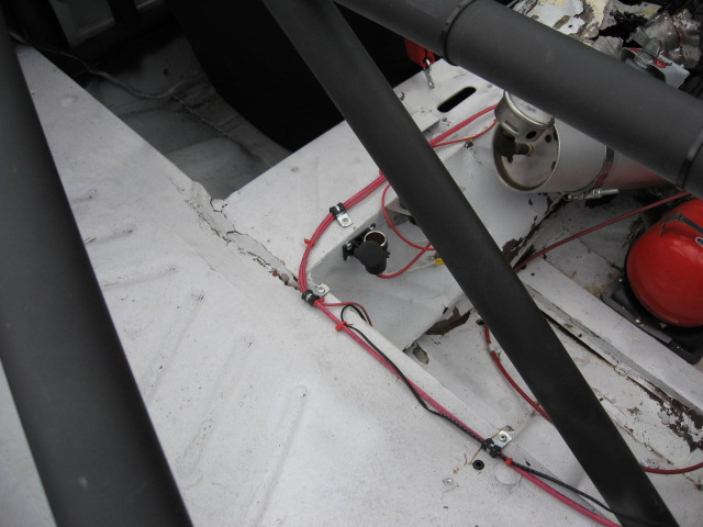

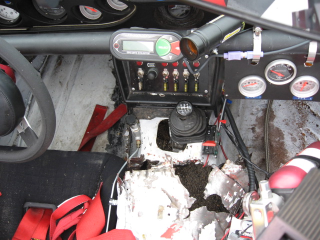

I reached down to hit my cockpit electrical kill switch but it wasn’t there. A quick glance revealed that most of the drive tunnel that my kill switch and accusump were mounted to wasn’t there either, and my gear shift was poking out of the tunnel at a really strange angle. I managed to turn off all the switches on my electrical panel and get the car pointed left of track.
As soon as the car rolled across the track curbing I was up and out, it was still rolling a bit as I jumped from the cage (open top cars quick to get out of, a good thing!!!!). The car was leaking fluids out of three places and I could hear a heavy flow of liquid splashing on the ground that turned out to be fuel from the broken pump and line system. The track was littered with pieces of metal, driveshaft, and exhaust system. I was a bit shaken up, no doubt.
To make a long story short it appears that the driveshaft broke. When it broke the car was moving and it was securely bolted to the differential, so of course it had to rotate. It beat the hell out of the transmission tunnel, broke the cross bar loop, and sheared off the exhaust system while turning itself into a 3” diameter metal facsimile of a snake.
The engine was spinning at about 5000 RPM when this happened so of course the transmission was being turned until I could shut off the engine. The output yoke of the transmission is a heavy u joint affair and it just about cut the center console in half while taking scattering shards of metal all through the cockpit. The accusump got deformed and vented oil making a nice shower. Electrical switch was broken, and my MSD timing control was reduced in size by about a third. Tunnel is trashed and the carnage goes all the way back to the rear deck.
Once we got to looking underneath the car we could see that the transmission is missing some casing and the differential isn’t being a differential any more. The transmission is pulled away from the bell housing about an eighth of an inch, so bad things are going on there. The diff sounds like a box of rocks when turned and input flange wobbles around in a non-circular way. Shifter structure is mostly gone, as is the transmission output flange, and some other bits back there.

You didn't mention any driveshaft safety loops. I'm sure they will be on the list of upgrades / repairs.
I had a U-joint failure that was not near as bad as yours in regard to damage done but it took out the mainshaft of the transmission and tailshaft housing. The other odd thing was that the rear end had a problem as well - Turned out that the shock from the failure had broken both of the differential pinion (spider) gears. This was in a 9" Ford no less.
Curious what could have precipitated the failure.

While it didn't have a drive shaft loop, it did have "anti pole valut plate", a stout quarter inch metal plate connecting the tunnel and would hold up the shaft. It was bolted in place with 5/16" bolts with 3/4" washers - clearly not enough. That was ripped out of the chassis and I don't know where it went. Gone, so it didn't serve the purpose it was supposed to. Yep, if we rebuild this thing it'll have a proper loop as well as some "armor" around those rotating bits. I'm happy to be typing this now at home in my red chair with my cat, instead of being in a hospital somewhere, or worse.

What an ordeal! Those pictures of the drive drive train tunnel look like a grenade went off underneath the car. I'm working on a '70 Mach I project with my son and I'll alter the list to include a new balanced drive shaft. Don't want to take a chance with the old one after seeing what a broken one can do.
Fortunately, you flipped the kill switch before the energy found its way into the motor. Long ago, I had a '67 Corvette with a 427 and I got it stopped right when I first heard noise. Saved the numbers matching motor but wound up with two sleeved cylinders. If you're quick enough, there's always some good news that comes out of the bad.
