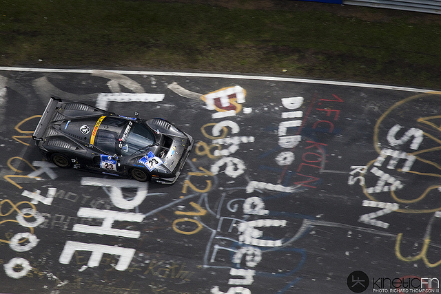

We're making a lot of changes including KERS and will be back for the 2012 24 Hours of Nurburgring.

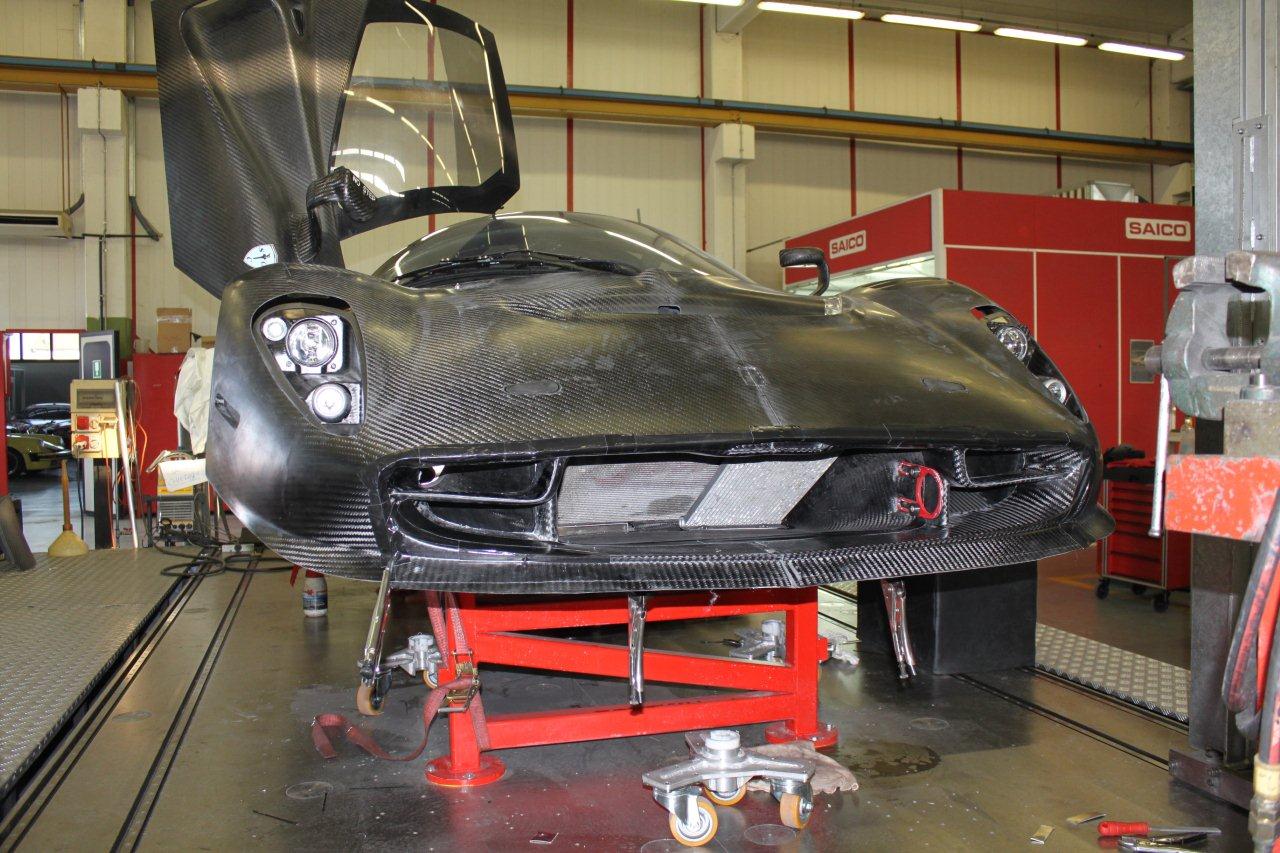

Very interesting. The KERS being used is from the F1 design? Why the decision to change the nose? Air flow? Regulations? I was hoping one of your cars would have been at this past weekends Amelia Island.....maybe next year. Fingers crossed.

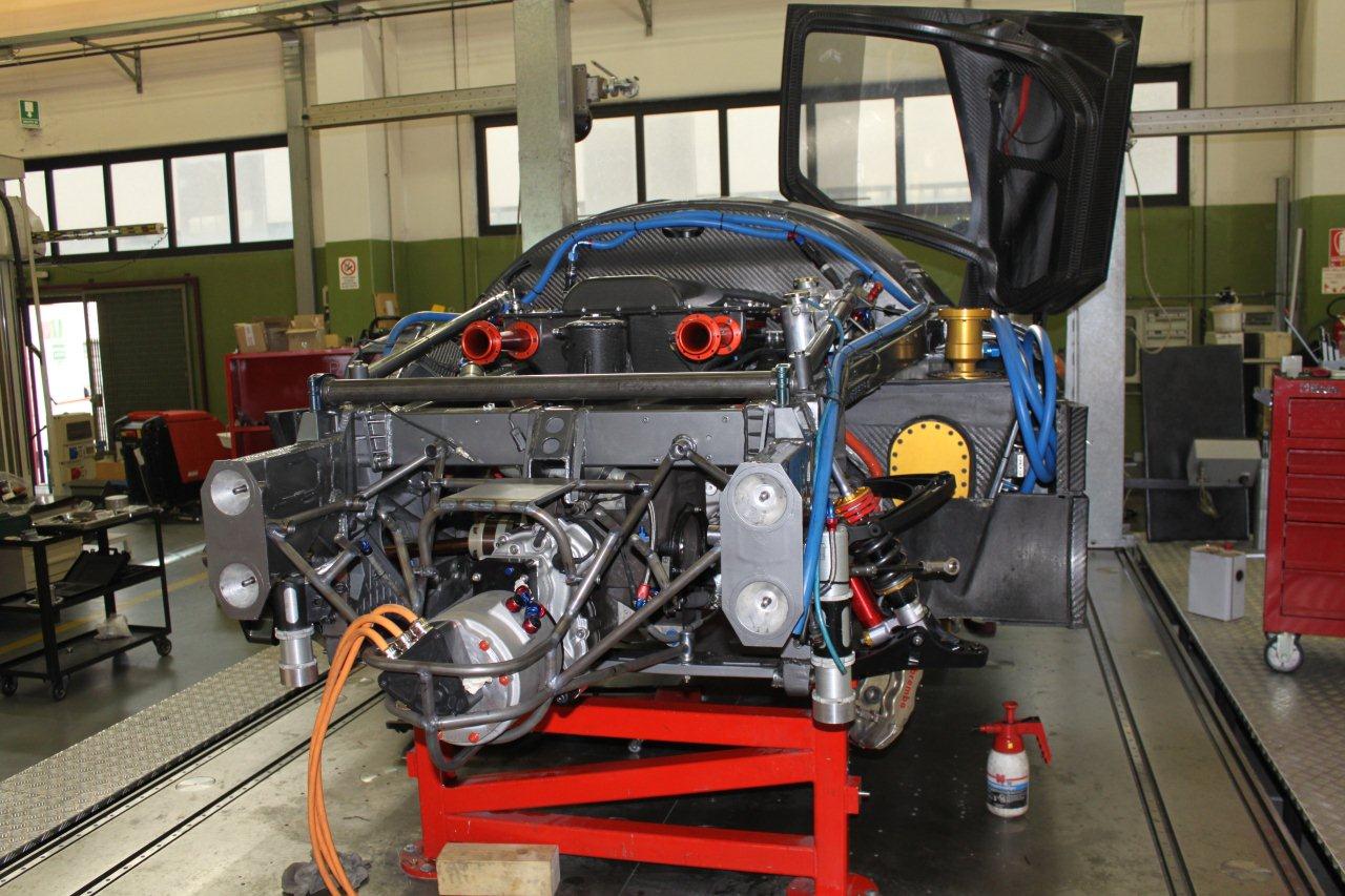

I think I will be there next year and if I am please say hello! Our KERS is an F1 unit. We're also doing a lot of development work on the engine and so far have found more HP. (restricted engines are very complicated especially in endurance tune) We're changing the nose to lower frontal area. Our fenders are lower as well. We're also reducing inlet as we have enough cooling and ducting radiator exit air to the sides of the car. We re engineered our underside diffuser.

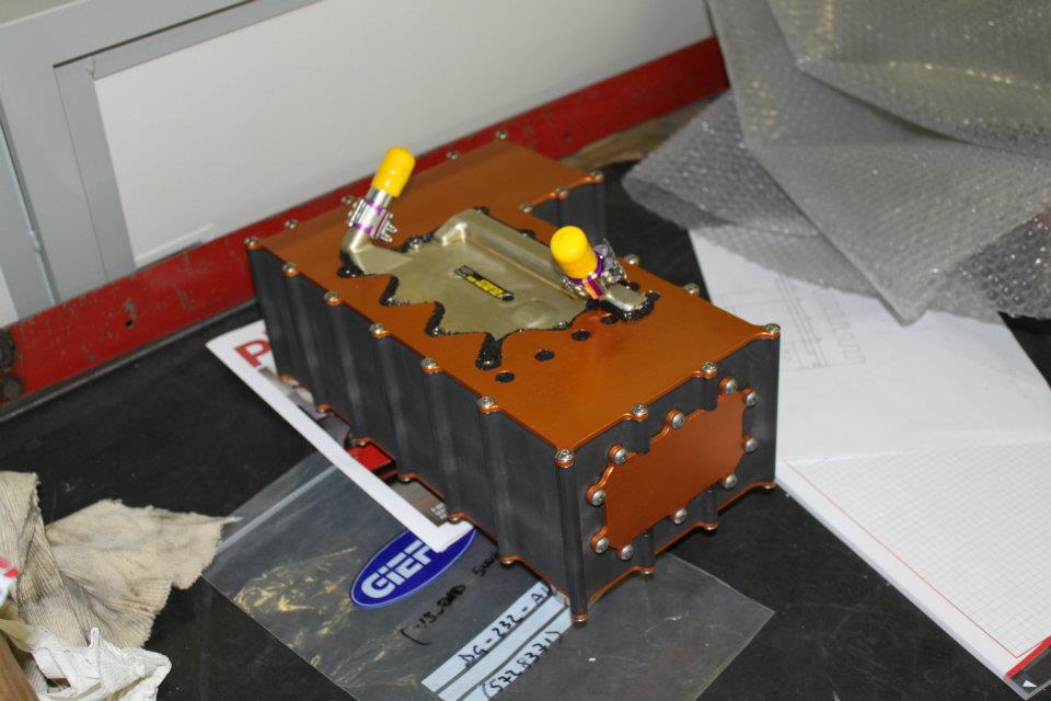

Our KERS is real in that we're re capturing brake energy and hope to make 50 seconds of KERS HP per lap (8:30) Remember we run the Ring you know plus the GP course. On the Ring you know we hope to run 7 minute laps for 24 hours one after the other.
Cheers!
Very cool! I am assuming the KERS is electrical versus hydraulic based on the photo of the inverter. Is the energy storage batteries, supercapacitor, or flywheel based? Fifty seconds of "boost" would seem to imply significant storage capacity.

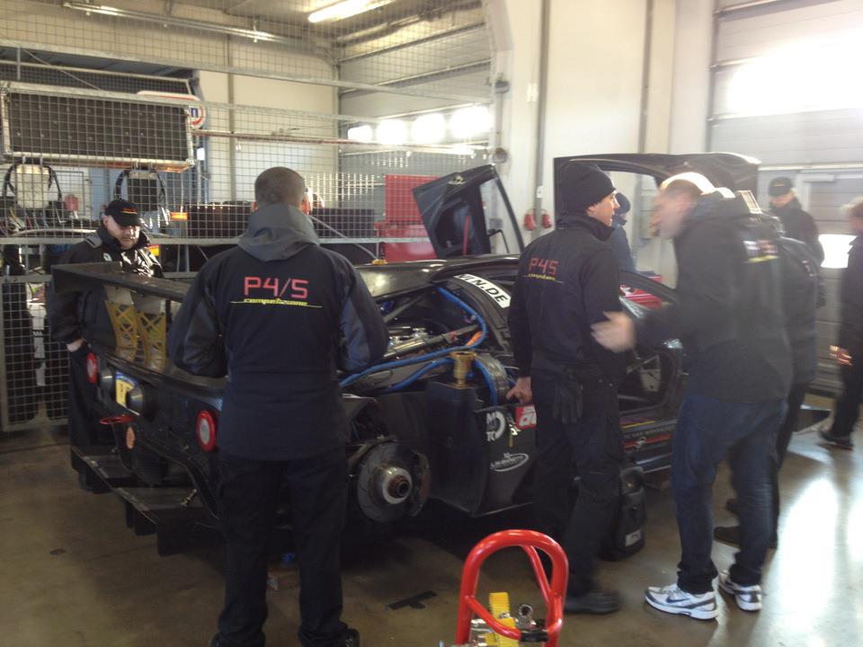

Testing at The Ring
