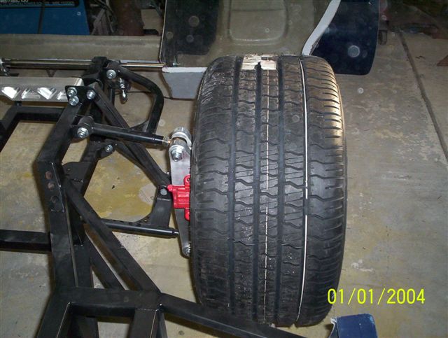

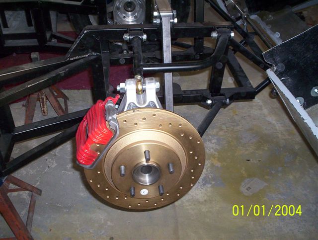

Front suspension/brakes is 84-87 Corvette.
Coilover shock isn't ordered yet..but you can see
the upper mounting tab. The rotor is Powerstop 11.50 ".
I know it's on the wrong side...just doing a fit up check.

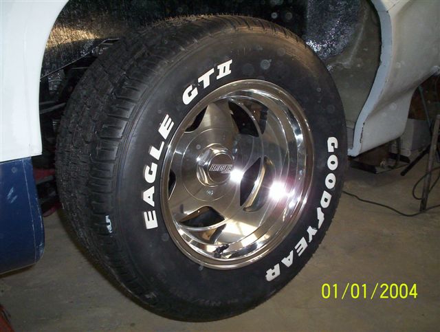

Surprisingly, Eagle 15 " wheels clear the Vette Brakes.
Tires are Goodyear 295/50-15. Unfortunately the
Halibrands and Z-rated rubber will have to wait a while.

Mike, it looks great.

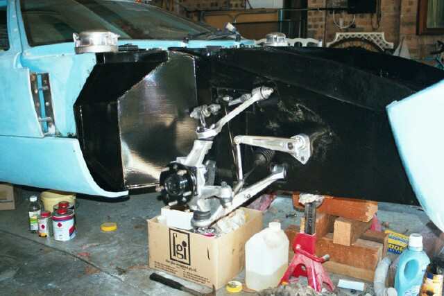

One interesting thing I noticed was the angle of the top front a-arm. The DRB GT40 uses the same '87 Vette setup & the top arm mount is angled quite severely down at the back (see old pic of mine).
My recollection of my old '89 Vette was that the arm sloped down toward the back (but not as much as the DRB).
My guess is that with a big slope, the castor angle will increase substantially as the susp is compressed. Whether that is a good/bad thing is beyond my ken, but it would be interesting to hear some of the experts' opinions.

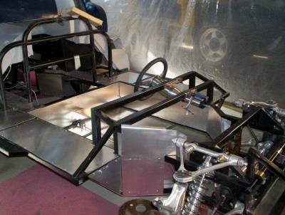

Slow but steady progress...

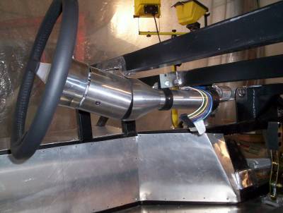

Decided I wanted to use the Ididit shorty column rather than
a race type column....required some minor alterations to the cowl tubing.

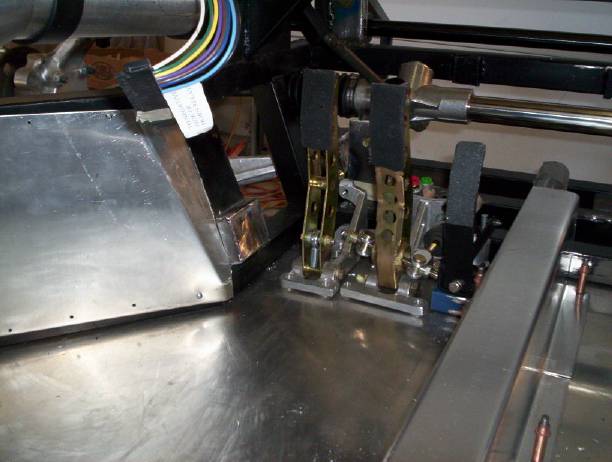

Tilton pedals.
Also decided I preferred left hand rack (sorry Fran).
This one is Flaming River quick ratio. Very light.
