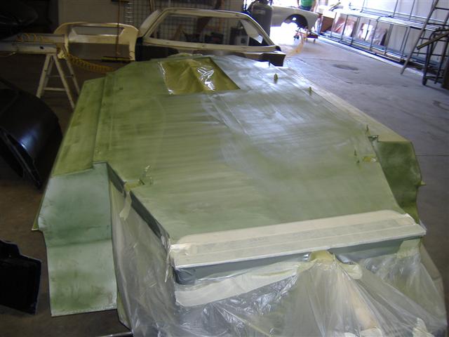

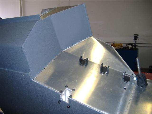

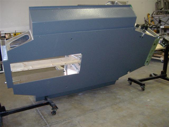

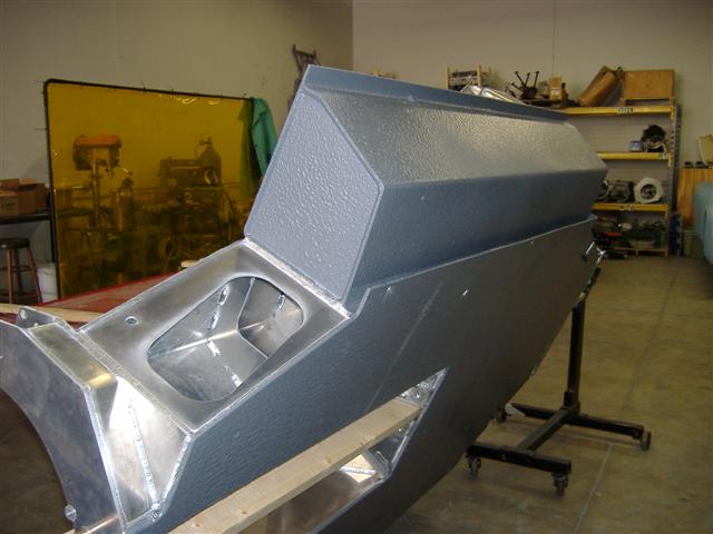

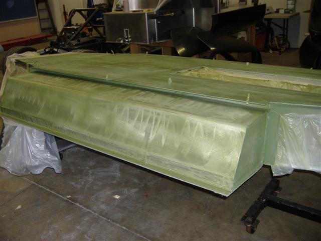

Due to popular demand we have decided to offer a rubberized coating option for the chassis underside.....
We feel doing this at he factory prior to the roller packages being assembled and shipped will help with the cusomters build process,. .
The coating is applied to a heavily scuffed chassis once the surface has been treated with a 24 hour surface etch/primer and then a 1 hour adhesive treatment....
Four gallons of the rubberised coating is then applied and left to cure for 24 hours ...... and gives 1/8th-3/16th thick coverage
The option cost for this process is $750 usd.
