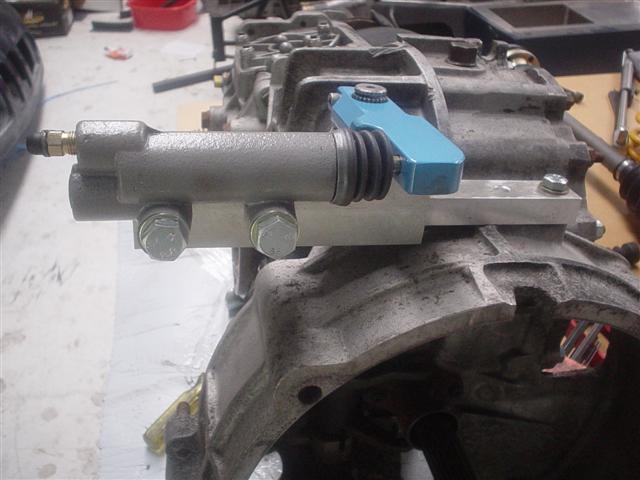

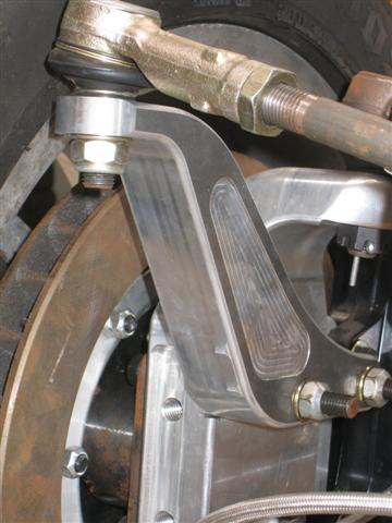

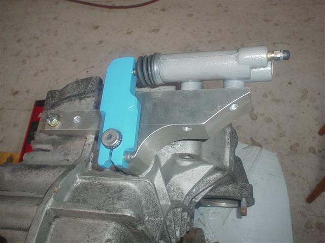

After a lot of agonising over the "930" clutch slave apparatus, I've finally concocted this-- as prototype-- a bit more refinement and it will be billet machined from Al. simple, easy to attach and fits RCRs .
We had to do something with the steering arm as well

wots the story with the steering arm then?? steve

Stevo ---Rust! Queensland's humid weather is detrimental to all things iron , so an Aluminum replacement item had to be produced and hopefully counteract some bump steer

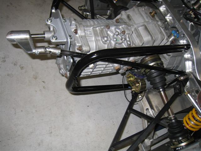

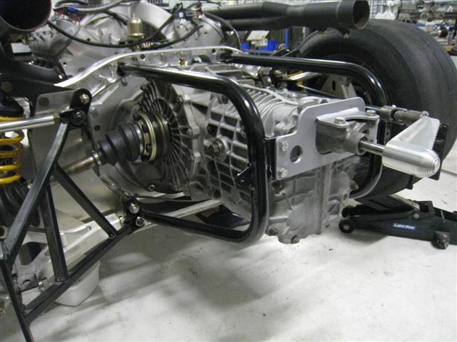

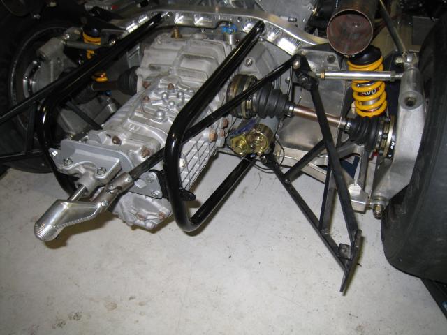

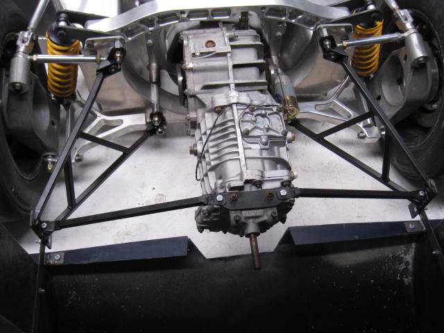

Countless hours of procrastination and I've finally concluded the trans support

Looking good Chris...
The trans support looks a good bit beefier than the one I made for my Forty..
Could you show some close-ups of the mount and attachment points?

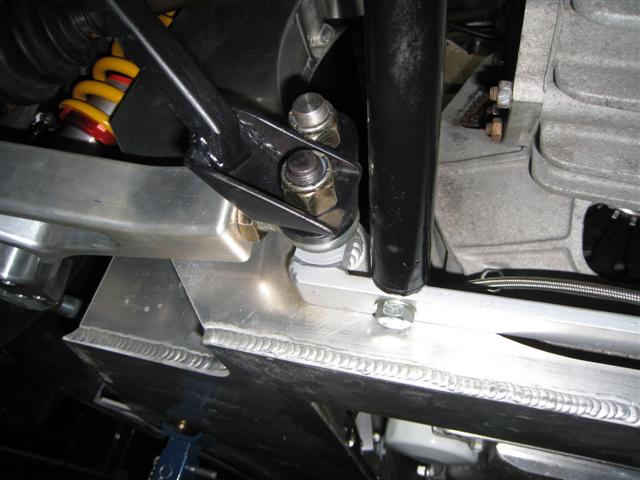

Damn --I new you'd ask that Randy,--- The main "hoops" are 1" tube with threaded plugs welded in each end --bolts thru the upper cross brace and bolts to a lower cross brace between the inner lower A arm posts. best I could come up with out further procrastination.
Slave cyl. mount for "930" clutch :-

Thanks for posting the close-ups Chris...
I've been scheming on a method to tie the two lower control arm bolts together "behind" the heim/rose joint... Looks like you've done a tie-bar of sorts just in front too...
Many thanks...

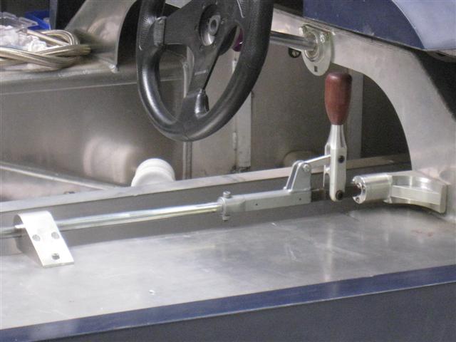

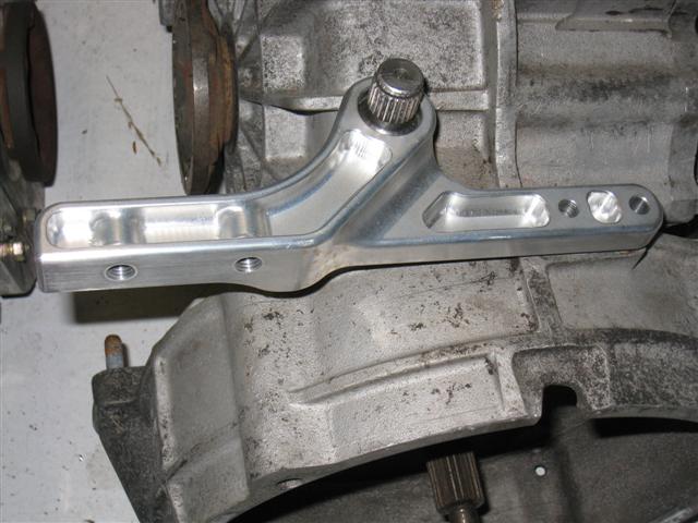

And -- my miniscule efforts towards a single rod gear shifter ---seems to work good

Love the NC machined parts. Looks great.

molleur
Join Date: Mar 2008
Location: Florida
GT40: SL-C LS1/930LSD
Posts: 1,962
Re: Another first...Australia
Very nice single rod solution. If I'm unhappy for some reason with the cable setup on the 930 that I'm using, I intend to copy yours...
