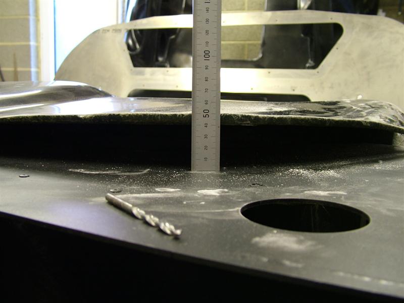

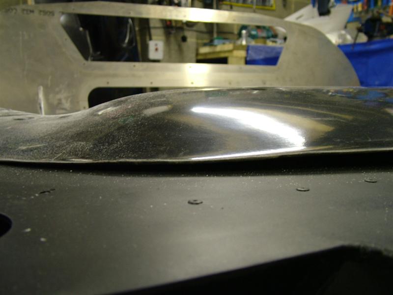

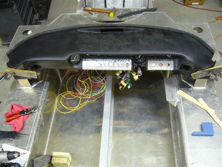

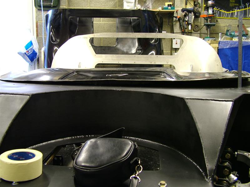

As you can see it varies massively from side to side, if I pull down the pass side it'll pull out at the front & there'll be a lot of tension on it. Seems like it came out of the mould warped.
Jay

Don't worry. It is not uncommon for the fiberglass to curl after it comes out of the mold. Just force it into place. Hold it there for a while and it will retain the shape. The fresh resin is quite fluid and will give over time. For example you may find the rear lower corners of the front clip will curl inward. The top of the spider will sag slightly, leaving a gap between it and the windshield. I put a broomstick inside holding the spider up in a position just slightly higher than where it needed to be. Three days later it held position without any support. I would just place it where it needs to go, add a little (or a lot) of weight as needed. Fran also suggested a heat gun can be used to speed up the process. Don’t over do it with the heat. I found that if you place the part in position, warm it slowly to where it is not quite too hot to touch, let it cool and it will retain the shape. So don't be afraid to push your fiberglass around a bit to get it to fit.

Got it clamped down into shape so we'll see if it stays where it's supposed to.

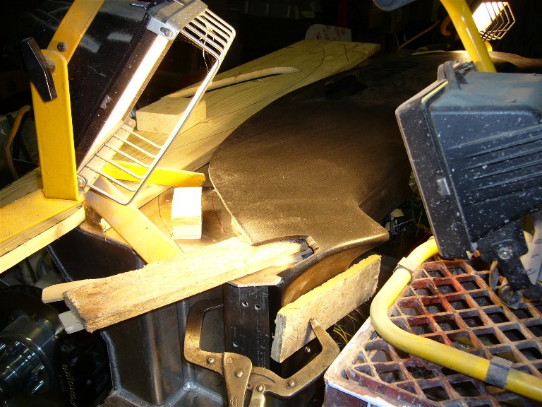

needs a little heat to make it work,at least sunlight

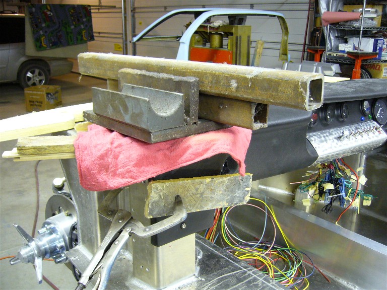

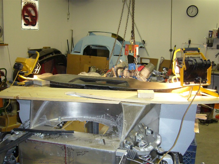

It is supposed to be raised off the dash structure just a bit though... so suggest a thin plank of wood ~3/4", clamp and heat or direct warm sunlight. The warpage should come out no issue.
I have changed the shape of a quite a few fiberglass panels this way in the past.

I had a similar problem...I tried it out in sunlight but it wasn't enough heat so I got a couple of those red heat lamps and hung them above while clamping the dash down and it worked well. Don't get too close with this method, and be patient and it will work. Also if you clamp try to spread the force so as not to create more deformation than you started with such as rob suggested with a plank.

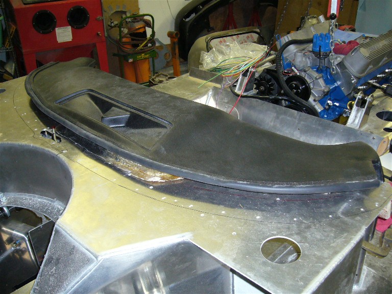

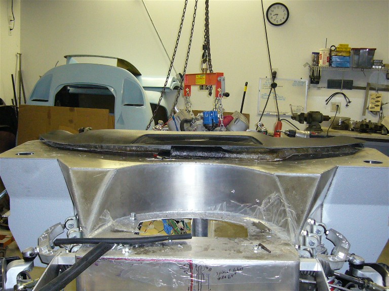

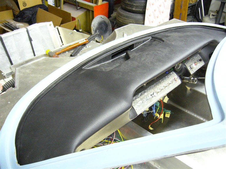

Rather timely discussion, as yesterday I tackled the same demon. Below are pics of the process I used. I first fit the dash, by trimming the bottom legs to sit flush to the pillars, then notched the top of the legs to fit the dash sub structure, clamped in place, fired up the spot lights (aka poor mans heat lamps). Once the material was getting hot to the touch, I started inserting paint stirring sticks one at a time (with some time between). I exceeded the desired position by ~10% assuming some relaxation (historises) would occur. Let cook for a while at this position, then removed lamps and applied weight. Added bulb type weather strip..and Baddaboom...baddabing... good to go. Hopefully this helps you.
Rob

The substructure is the plenum that we have been working on for the AC system to eliminate all the hoses dangling under the dash....it works well and is very clean....its a standard part with the RCR AC system that everyone with a DP kit will receive...very very shortly.
