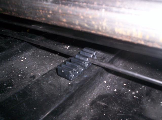

Could you try and use these sort of clips.
I used them all over my car to secure the brake pipes.

And we ran the lines in this type of clip
https://secure.visav.co.uk/avshop/pr...at=29&scat=128
Doubles can be a pain to locate but I think I may still have a contact number somewhere from Jaguar spares.
