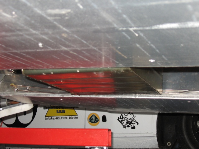

I'm building a Ford 302 -347ci and I'm planning on using a Canton Road race front sump oil pan with 7 1/2 inches of depth part no.15-630. Will this pan work in the RCR GT40?

It works perfectly. Check my Lola build thread and there are pictures of it sitting perfectly flush with the bottom of the chassis.
EDITED - here you go with a picture:

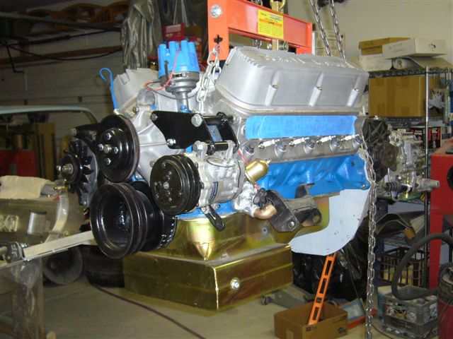

Sorry man.... I already got the GT40 one....... :-)
Seriously... It works perfectly. Fits ideal in all directions.
