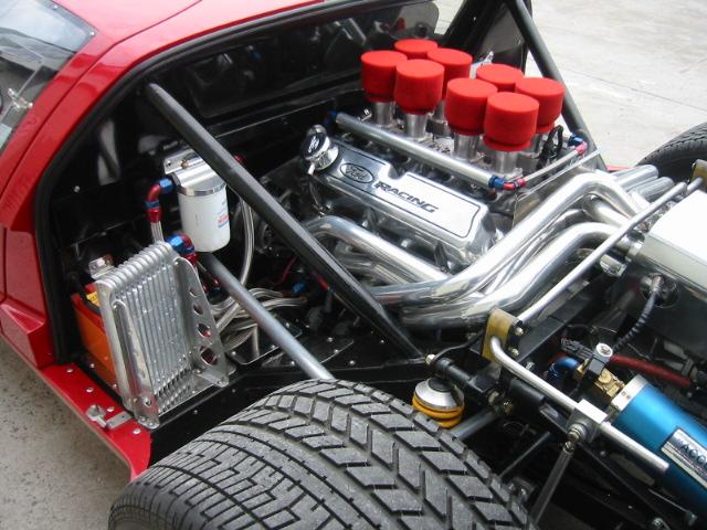

Bill, not an RCR but my filter is mounted here.
File Type: jpg Finished Ready for Delivery 12-10-05 056 (Small) (3).jpg (70.2 KB, 169 views)

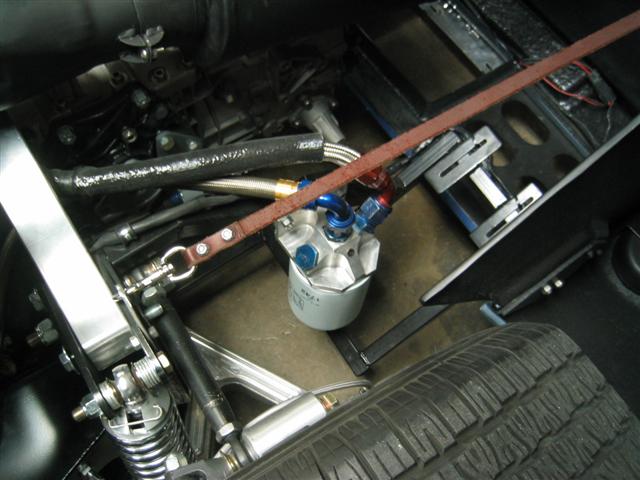

Here you go Bill!
